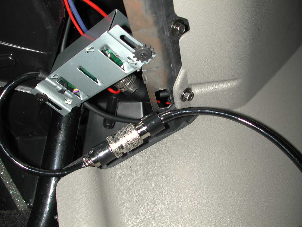

I INSTALLED MY COBRA 75 PER "GLENN" ON POST DATED JANUARY 29,2003. WENT VERY SMOOTH. WILL TRY TO POST PICTURES.[IMG]CB INSTALL[/IMG]

<LI>[img]CBINST~1.JPG[/img]

[img]CBINST~2.JPG[/img]

[img]CBINST~3.JPG[/img]

I too have the same install as Phil. It works great even with the antenna folded down. Everybody who sees the Cobra75 mounted like in Phil's pic thinks its OEM.

TRYING TO SHOW WHERE COBRA 75 WAS INSTALLED UNDER DASH.

[img]CBINST~2.JPG[/img] HOPE THIS SHOWS WHERE I INSTALLED COBRA 75 UNDERDASH.
