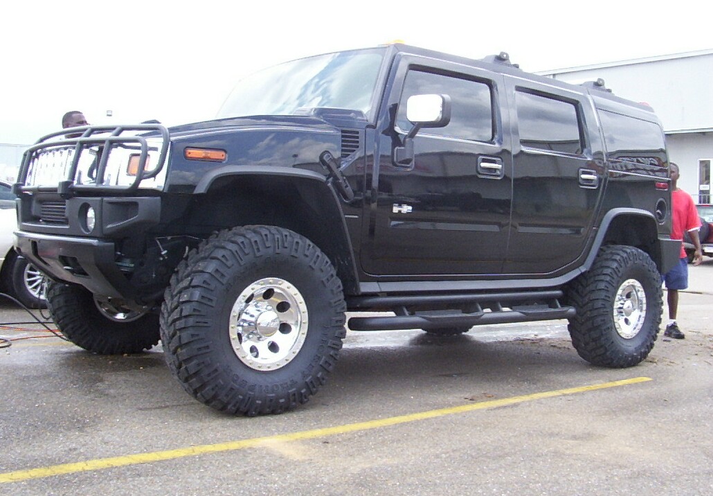

Well here is a pic of the new M/T beadlock wheel with 325/80/16 M/T Baja Claw Radial with 3 inch lift. Door sills are about 5 inches taller than stock. Rims and tires cleared with room to spare.
Dan from Alabama

Dan where is the pic???
1 minute late, would the tires fit w/o lift?

Tim
I think the tires would clear without any lift. Those are 16x8 rims with 4 1/4 backspacing. I believe a 16x10 with those tires without a lift might hit. In fact I'm pretty sure that they would. The 16x10 has the same 4 1/4 back spacing so the tire would be 2 inches farther out. Call me old fashioned but I like the look of that tire wheel combination with the taller sidewall. It just makes the truck look taller.
