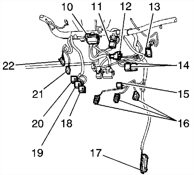

As you suggested, it looks like right behind the center I/P outlets might indeed be the best bet. The S212 splice is just too inaccessible.
In the diagram below #17 is where the I/P harness connects to the body harness for the power run for the rear AUX power outlet. Unfortunately, that harness connects on the right side of the front passenger wheel well. So I won't be sure if the harness it's easily accessible behind the center console until I open it all up. At the very least this will be the easiest place to relay one of the front outlets.
Alternatively, I might just try to switch the both front outlets and the rear with a relay right off of the 3040 wire right next to the I/P fuse box.

Old 07-06-2006, 07:07 PM
Default Re: Convert AUX power outlets to ignition switched or RAP
Originally Posted by ree
FYI Paragon,
Now I just need to courage to start snipping.
Attachment 24247
You can always wire it back together
I would do that. Not too many things are needed to be powered while the truck is off.
I haven't looked, but what about the 2 at the back of the center console? Are they on a seperate circuit? If so, then you would have the cigar lighter and those two that would still be perm power and the rear and 2 fronts on the RAP circuit.
Yes, those two on the back of the center console are on a separate circuit. So if I ever truly need always on power, they'll be available, albeit in prime kicking location for rear search passengers.
