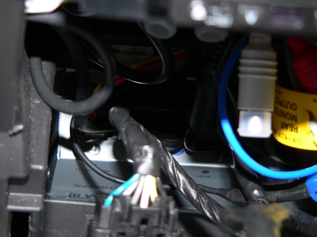

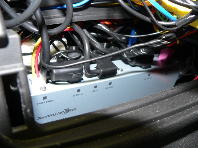

Getting ready for the install, but just curious about this mounting location for the XM receiver. How big is that module? I looked today, and it appeared there would not be enough room for the module and the back of the HVAC controls on the panel.
I have decided to place the camera on top of the trailer hitch in the center of the vehicle. I am in the process of designing a bracket to allow the camera to sit here. Just have to be really careful if hooking up a trailer.
Ok, I got some pictures of the Xm install. As you can hopefully see, it sits way down in there so the top of the XM box is below the HVAC controls.

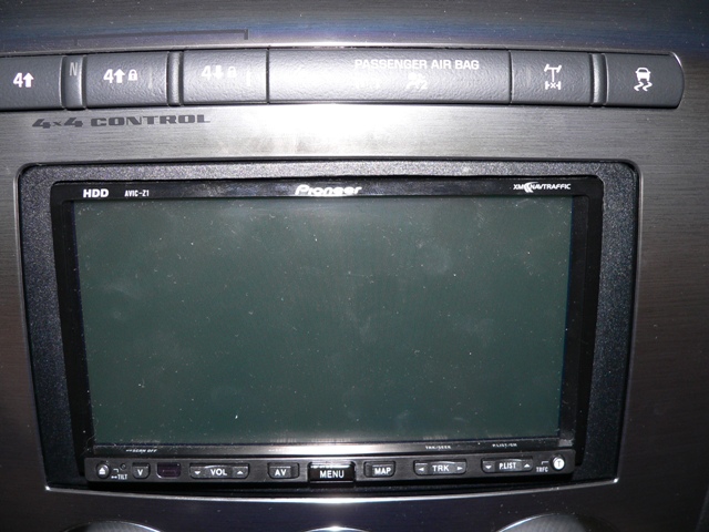

I also finally got the trim ring adjusted right. It always kind of bowed down and left a gap in the middle at the top of the stereo. It was really bothering me so I cut some small pieces of foam to put between the trim ring and the stereo. There is also a clip on the top edge of the stereo opening on the dash piece the needs to be bent slightly.
Here is the after picture
