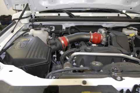

I got the true flow air intake installed today. I will drive with the open exhaust and this intake until Tuesday. Im supposed to get on the dyno then and compare the other mods.
Old 09-21-2006, 11:44 PM
Hunner's Avatar
Hunner Hunner is offline
Location: Arkansas
Posts: 363
Default Re: Exhaust,intake,throttle body spacer
oops dropped the photo! Im still grinnin from the exhaust so its hard to describe the intake. Seat of pants dyno feels more responsive throttle and more acceleration. Im noticing a little lower rpms at 65 mph. Hmmmmm

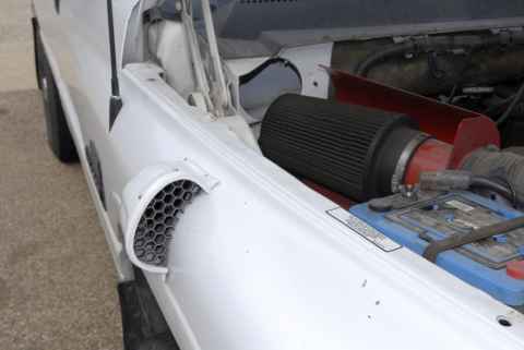

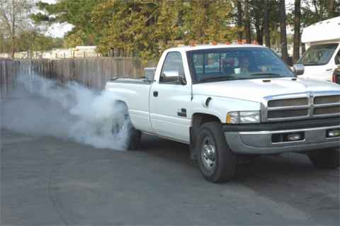

Im aware of the "fresh air" thru the fender idea. Back in 95 the same company that is working on the air intake now made the one under the hood for my Cummins but after boosting everything else I added the scoop and the hole in the firewall at the base of the windshield high pressure area.

It worked! Boosting 40psi it needs air! 300hp and 600ftlbs. I kept it down for towing. How would you ever control that in a Hummer?

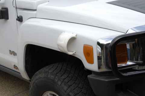

Here is a mock up. Im going to have to use a smaller scoop, maybe! I used a piece of an old grill on the truck scoop. H3 will need a mesh screen of some sort to filter out bugs, or not. Water will drop out in the box if it makes it that far or can insert a plug for really wet weather if it scares me. It should drop in the gap between the scoop and inner fender. It does on the truck.
I only have 3400 miles on the H3 I cant quite get up the nerve to cut a hole yet. I found that painting the scoop with matching paint made it last a lot longer. Just another crazy idea. I mean if you want outside air this will work. I will post pictures of what they make for my H3 Tuesday. They are probably going to make it an open shield type. Their idea is more air is better even if some of it is engine heated. The air under there should exchange at a good rate so we will see. I like the idea of the stock box for offroad. Just need to open up the thru the fender snoot. Im working on that whether I use the scoop or not.
On the Dodge Ram it was Ramair I guess this would be Humair? Now if we could actually use the fake air intake..............

I think wpage is saying to run a pipe directly from your your passinger duct (right below your turn signal) into the fender area. This would flood this volume with cooler air.
Old 09-23-2006, 04:47 PM
Where you show your mock up. Is where your stock cold air intake is located in the fender wall. Look from inside your engine compartment. In the air handler there is a 2.5" opening that leads to a air conditioning type filter that connects to a air plenum (chamber) between fender and wheel housing.
If you cut in at that point you may want to 1st pull off your fender to be certain to enter where you should. Otherwise you may miss your mark and have issues...
That is the "hole" idea!
On the truck I just put a pilot hole from the inside in line with the inner fender hole. I do think a hidden intake could work. There of course could be issues of submerging it which I dont plan to do. Im going to have to pull the inner wheel well liner to get in there and see how. A snorkle of some sort would work as well but Im not sure how it would look and the issues of the length of it.
I ordered some flares that came with metal/plastic push fasteners to replace the one time use ones on there now. Im going to see if they will send me some extras.

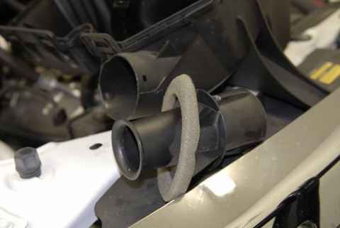

If you have not had this apart here is the "snorkle" end that goes into the inner fender. I stuck my hand down in the fender and all I felt was the back of the park/turn signal lamp. There ya go just take out the light and you got air! Trying to come up from the hole in the front cowl would be tough for clearance reasons and dirty wet air down that low. I really dont see how the air was getting in there except for a few small stamped holes and gaps. They had a foam seal like for what? Maybe the obvious to keep out some heated air but everything in there is heated. Im sure some engineer had a plan. I took off the snorkle just for grins because I want the stock lid on the box. It really muffels the sound back down to acceptable.
