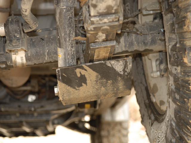

Here is a fresh shot with one on and one off. The one that is on is the design that needs to be 1 inch wider towards the inside to protect the bolt head. They will both be wider. Im trying to say brand "A" was not wide enough and the radius on the back turned up part is more so as not to stick out as much. Anybody see anything else missing?? You can also see my added 3/8 by three inch strip I added under the Rocky Road rock rails. I posted a shot on the thread but will stick it in here.

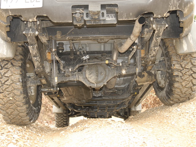

Posts: 363
Default Re: Spring hanger/shock mount skid plate
Just to keep interest up here is another in the field. Sorry for the dirt, not!

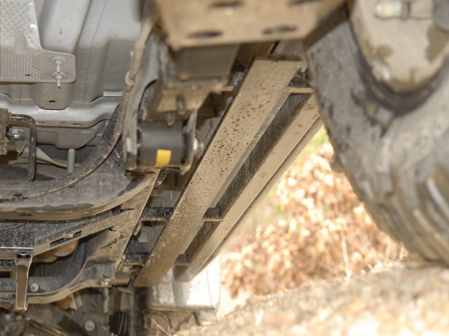

Added rail

Must have been tired when I added this one. That is the added rail I put on my Rocky Road Rock Rails say that three times real fast. Its not part of the spring shackle set Im not sure if I was going to add that on another thread eerr whut? Anyway I wanted to share that idea.

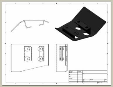

Progress. I took the tour today and saw the laser cutting out patterns. They have the program done for the skids. Im pushing as hard as I dare. I will post a picture of a pile of them when I get them.
It says I can attach a pdf file but nothing happens. Sorry, I was going to show the cad drawing. Maybe too big? 179 kb
Bring up the CAD drawing, press "print screen", open Imaging, select new, right click, paste, trim, save as and post.
