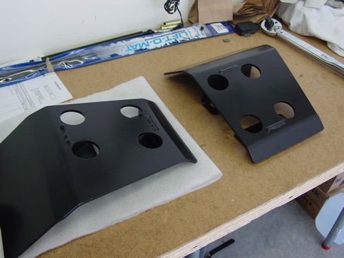

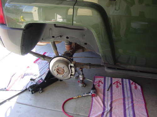

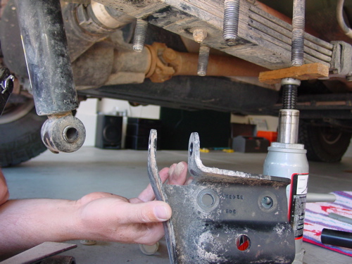

No long explanation needed. Just take off the U-bolt nuts and the shock bolt and put on the skid. You can get it all back up and then compress the shock to get it in. My friend and I did these yesterday in 45 min. I reccommend powdercoating! That was the first time that I had parts coated. DO IT!! It was 40 bills to do both plates. BEAUTIFUL!!!
I am glad I had my air system finally hooked up to rip the nuts off. Previous wheeling and abuse made them a bit tough to get off. Thank goodness I wasn't using a wrench.
