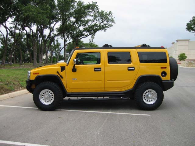

I didn't run mine on factory rims, but ones that were the same size.
From what I remember - it didn't make a huge difference in garage clearances. Ones that I had to avoid were ones that were already too short for a stock H2. It's not as dramatic as a lift.
They do have more road noise then the ATs, but just turn your stereo up, it's not that noticeable.
I love the wear on these tires. I have 25K miles on them and they're hardly worn at all. I haven't run them in snow (no snow around here), but they perform great on wet pavement and offroad.
If you get a GOOD alignment, they shouldn't rub at all. I would avoid taking it to the dealer unless you have a really, really good dealer.
Here's the 37s on a stock H2:
