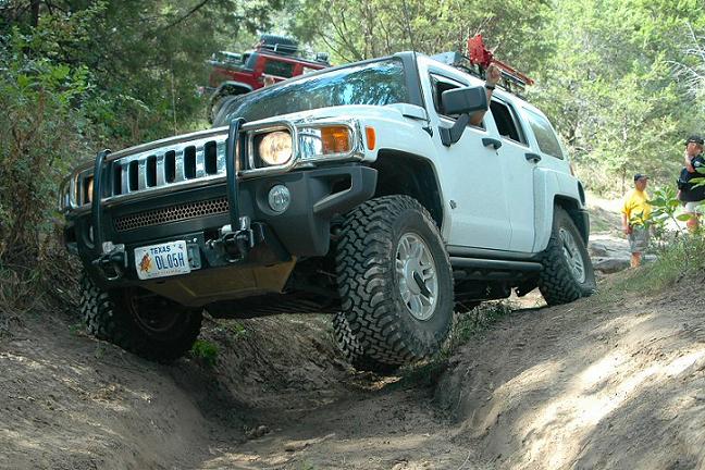

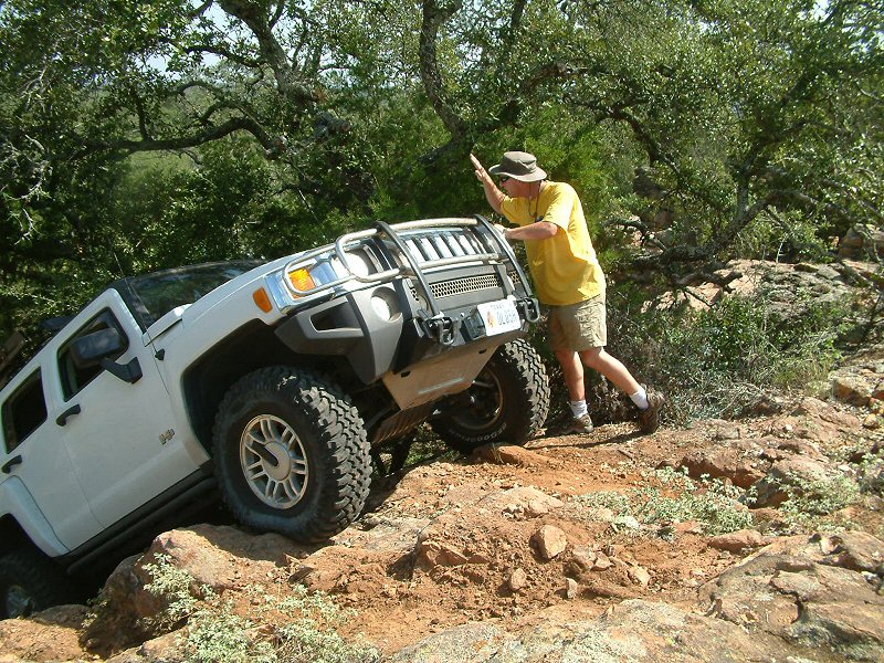

Mine is turned 5 times to nearly level and compinsate for the weight of the winch, I have gotten the alignment but still lower mpg, another thought could be the increased angle on the front shafts and cv's could be adding friction on the drivetrain makeing it work a little harder( just throwing things around ) heres my ride
Attachment 45618
Attachment 45619

Originally Posted by Big Dad
Dude,
I don't see no winch on the front of that thing -- did you perhaps mean wench?
Look closely at the front license plate, you can see the rollers behind it, I could use a good wench for it, just want one for free this time , I've been a sugar daddy once waay too expensive I want some free love
