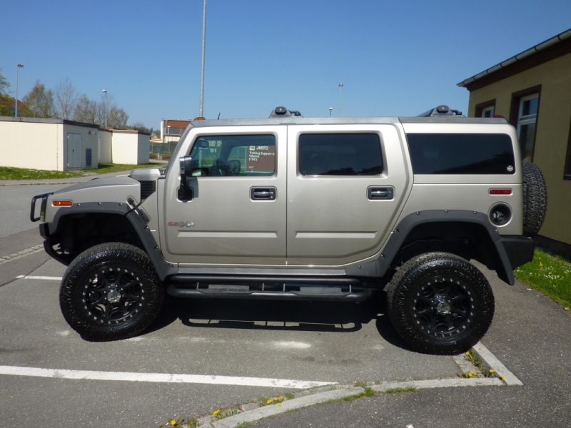

2003 H2, 408 CI, K1 Forged 4" stroke crank, K1 6.125" forged rods, Wiseco X-Series 0.30 forged pistons, Schneider cam, FAST 102mm LSXRT, precision flow injectors, Comp Pro Magnum rockers, SA Gear DR timing set, ARP main studs, 90mm ETC TB, Airaid MIT, MSD Coils/wires, Dynatech Headers/high flow cats, Magnaflow, Jessie James Black Widows 20x9, Nitto Dune Grapplers 37", Fabtech 6" lift, CK Performance XHD 4l70e and 4.56 Gears

SOOOO how does it run ??! with all those motor mods? are you happy with the gains?

It runs great. Pulls 100 mph in second gear....had it to 120 and backed out in third, i am not sure if the Nitto Dune Grapplers are going to come apart above those speeds. Would love to see how fast she will do on the Autobahn with the right tires.....I am in the process of getting 4.56s installed instead of the stock 4.10s. When I am doing 70 on the autobahn, she is almost at an idle with the 37s. I have been working in Afghanistan, but plan on going back to Germany soon and finishing the truck. Still need to get the tranny swapped out and the computer reprogrammed for the gears. I am thinking about putting in the Lunati high rpm hydraulic roller lifters so I don't float the valves at 7000+. The stock lifters are only good for 6800 or so. Hard to tell exactly how high she is revving when the tach is pegged.
