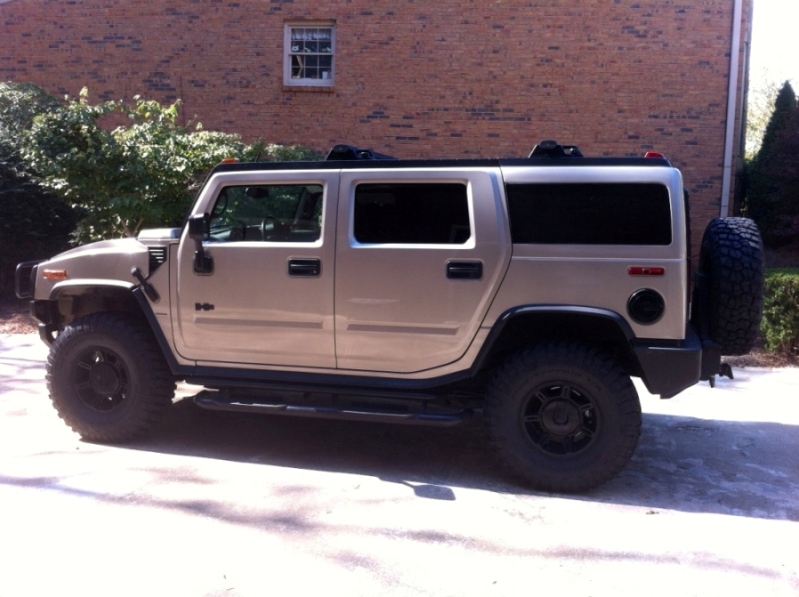

Just got new KM2s 37 12.5 17s stock suspension, no torsion bar adjustment.
2005 Hummer H2 LUX
Whipple SC
Ceramic coated headers
