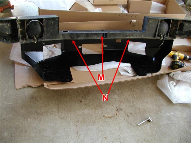

It wasn't a matter of being careful or starting them slowly. It was the way everything lined up when I went to instal everything. Before you put the bumper on, put all of your two hook bolts in and tighten them. Either I missed a step or forgot to put all of the bolts in and tighten or something was misaligned. Both bolts were that way taking them out of the tow hook threads. Strange both were the front bolts too. Just be cautious... those bolts seemed soft and may snap if forced too much.

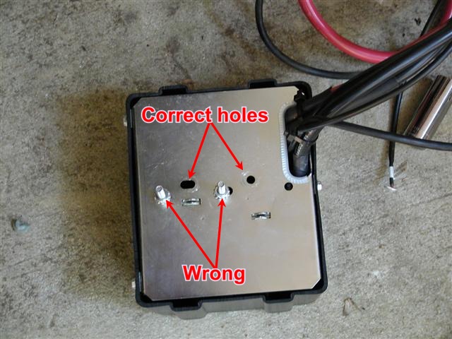

Thanks Fever for the great deal and all of your follow through on this. <HR></BLOCKQUOTE>Which bolts? Mine was the bottom on the passenger side for the bumper itself. The bolt for my Cibie Lights (which replaced my DRLs and are bolted to the top of the metal bumper) hits the control box and made it difficult to line up in hindsight. If I would have caught it before I put the wrench to it I could have avoided the crossthreading.
Was the bolts in the bottom of your control box backwards? Mine were in the holes farthest from where the wires come out and wouldn't bolt up because it hit the body. I moved the bolts to the other 2 holes and it then worked fine. On mine there were tool marks around the holes that I had to use like the bolts were there at one time but got moved.
You didn't miss a step or anything, the dumb-rections said not to put the bolts in the front 2 bolt holes on the hooks so that the hooks can pivot down and you can tighten the nuts just to the inside of that opening.
