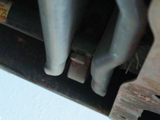

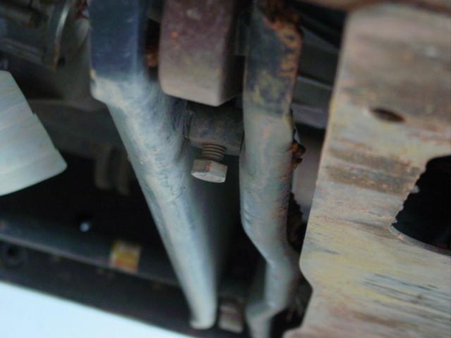

Anyone else have torsion bar adjustment bolts adjusted so differently. My passenger side is adjusted all the way up and the driver's side is adjusted all the way out (or, if even possible, backed out)

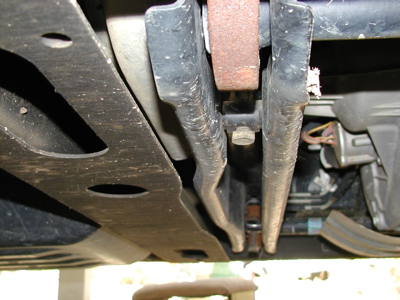

Here are pics I just went and snapped of mine. They have never been adjusted to my knowledge.

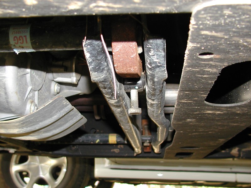

03-24-2004, 03:42 PM
Location: HereNoMore...
Posts: 292
the other

03-24-2004, 04:10 PM
Mine have never been adjusted. I was taking off my side steps for this coming weekend and happened to notice the bolt. Some of the top threads on the bolt seem to be "cleaner" than the bottom ones so it would seem the bolt backed out, BUT those bolts are under some big pressure created by the torsion bars, so one would think backing out would be difficult.
I called and spoke to the local dealer's Hummer service guy and he wants me to bring it in since both bolts are adjusted so far apart. By the way, I put a quick measuring tape to the front end and there does not seem to be much difference in height from side to side.
My luck they will have to order a new torsion bar and I won't get to go to the Happening this weekend.
03-24-2004, 04:40 PM
Location: Florida
Posts: 216
If your went to the dealer a checked some other H2's, you would find they are all different. Some have the driver's side cranked up more and others may have the passenager's side cranked more. The dealer should be able to adjust the "Z" height to stock specs and do required realignment. Anytime time the torsion bars are adjusted the alignment can move out of specs.
I cranked my torsion bars up to increase front end height and get away from the raked look that most GM trucks tend to have. Since I have the standard rear suspension, no adjusting rear air bags, this worked. The ride is a little firmer, but better overall.

I made very quick and potentially highy inaccurate measurements by measure the top of each wheel well. Side to side is the same front and back, but the front is less than 1/4" lower than the back. Not enough difference to be noticeable and I looked for it when you posted originally about making the changes.
I guess the thing bugging me in the back of my mind is that the truck seems to sit normal right now, but the torsion bar adjustments are polar opposites. Makes me wonder about frame or other problems. Also the one bolt "looks" backed out because the threads are different but again the truck seems to sit normal. The driver's side "key" looks to be resting on the torsion bar and the bolt is not engaging it at all, so the bar isn't really loaded.
Oh well, I'll find out today or tomorrow and if they have to replace the torsion bar, maybe they can get one in before the weekend.
I can just about be positive it hasn't always been like this (had it for about 20 months). I like to crawl under and just look from time to time (all vehicles) and this was way to noticable for me to have missed it before.

03-25-2004, 01:18 PM
Heard back from the dealer this a.m. They are going to replace the torsion bars but of course have to order them. Won't be in until next week.
Service tech said will be OK to take out this weekend on the Happening and shouldn't have any troubles. He can't find that they are affecting anything but are definitely not right with the adjustment bolts adjusted so far differently.
