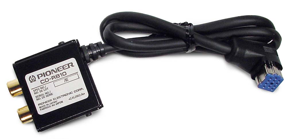

Yes, you can. You will need another adapter, an IP bus to RCA adapter. The end result will be:
Soundgate PIOGM1V2 --> Pioneer GEX-P910XM --> Pioneer CD-RB10

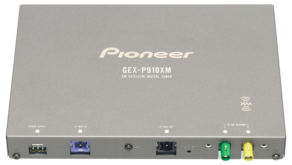

Yes, the XM module and the RCA adapter should both work. You are correct, the XM module has an input and an output for another Pioneer device, such as the RCA adapter.

Here's the Pioneer XM module.

When I ordered My adapter from soundgate (PIOGMV2) they told me I could us the PIO/P-RCA adapter to conect any additional device through the xm 910 tuner. Is there a difference between that and the Pioneer CD-RB10 you have posted here?
Check this out and tell me what your think.
http://store.yahoo.com/logjam/piepioprca.html

The PIO/P-RCA looks like a third-party version of the Pioneer CD-RB10. If Soundgate said it will work it should be fine.
