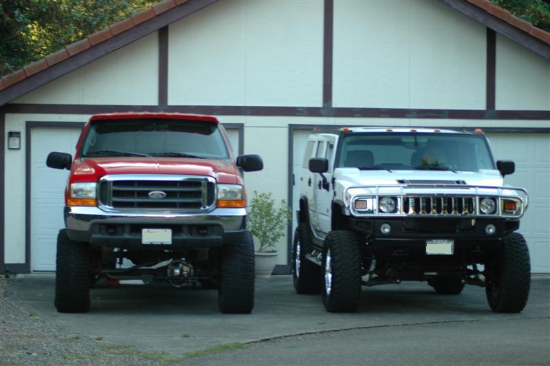

OK, had the lift done on Wednesday and have been working out the kinks. We went with the 6" Fabtech lift with the steering kit. If the guys at Fabtech aren't BS'n me it's one of three steering kits installed so far. They have one and there is one other besides mine. It added new Tierod ends (sp) which are about 3x bigger than the old ones, new pitman arm and the steering stabilizer. It's pretty tight so we're working out getting it to loosen up. The ride quality has not changed and I think is even better. The height is not an issue. If you're running stock tires than I think the height would be a little too dramatic. It doesn't make usability difficult so Stacy I think you should do it! Visibility is great! I can see over everyone again! The only issue we're dealing with now is the steering kit. The parts in the kit are so much beefier that steering has become too responsive! It's actually a little bit scary at freeway speed. Schwab Corporate has actually sent a rep to Fabtach to talk to them about fine tuning the steering to get it resolved.
All in all I love it and the guys at Schwab have been fantastic! Now I think I may need to get a little bigger tire.
Before, next to our Ford (38's w/9" lift) for comparison.

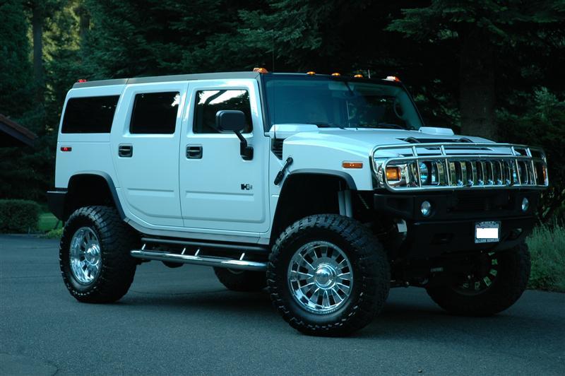

After .

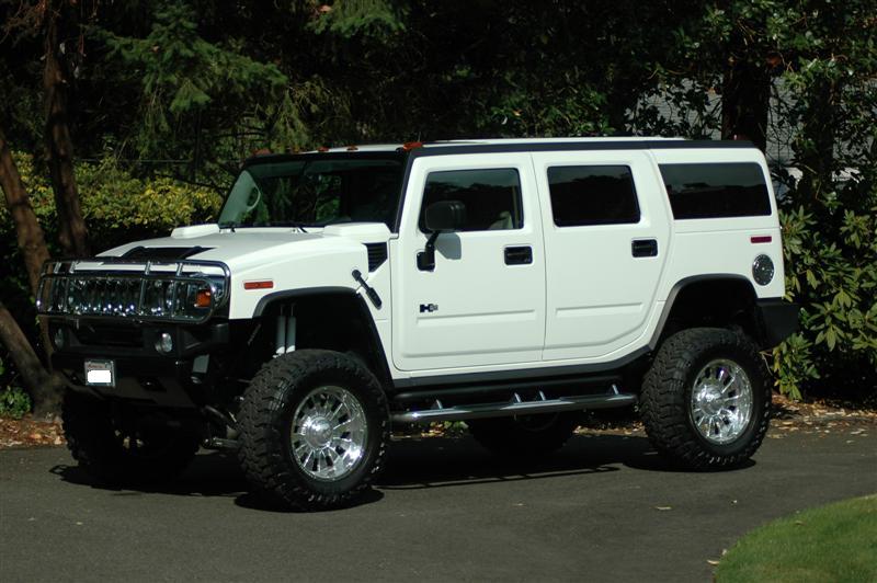

another view

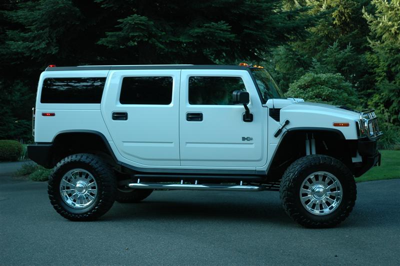

Another

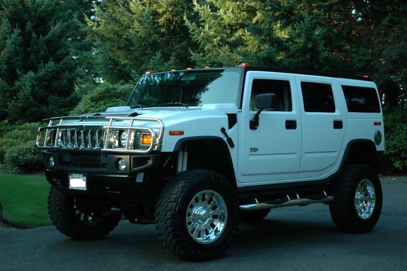

Another.

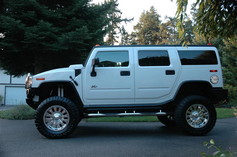

Last one. I'll post more of the underside later.

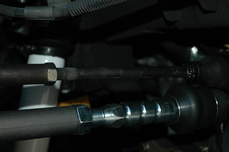

Here's the old tierods as compared to the new. The steering kit is a phenomenal upgrade in beefing up the front end, however I don't recommend installation until they have resolved the issues we're having with the steering.

Wilfred, let me know how your kit works out for you. I don't think our problem with the steering has anything to do with just getting used to it. We've lifted vehicles before and we've dealt with that. This is much more extreme. Even the guys who did the install said it's not normal. It darts pretty severly from side to side with the tiniest movement of the wheel. It was doing it on it's own at first. Felt as if you had an extremely over-loaded trailer fishtailing behind you jerking the truck around. They've toned that down somewhat by changing the toe, but it's still not right. It's better, but at higher speeds it's still pretty scary!
Let me know how yours turns out, i'm curious as to how yours will feel.
My husbands theory is that the original shock on the stabilizer was 16" long. The new shock, which is much larger in diameter, is 22" in length with only 2 1/2 inches of shaft exposed. So it seems to him that instead of having of a dampening effect, it's created almost a solid bar for a steering stabilizer. Does that make sense? If anyone has any ideas I would appreciate the input.

Also, I assumed you guys did an alignment, right? Maybe it needs more toe-in?

Yes they did an alignment and toed-in as much as they could without causing wear on the tires. That actually helped but not enough.
