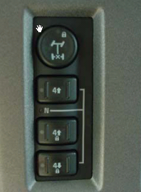

Old 01-28-2005, 05:06 PM
VernB VernB is offline
Location: Gilbert Arizona
Posts: 78
VernB is off the scale
This is the rear diff lock and location.
