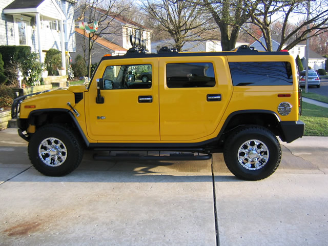

Anyone know what the tolerance or acceptable measurement is from ground to the fender arch line (F&R)? I had a Land Rover Discovery with air suspension and the rear "squatted" a bit compared to the front. The dealer said it was normal. My Honda Odyssey minivan squats also. I'm seeing the same thing on my H2 (see pic). Is this the case with all H2's with air suspensions? I hate the look of a squatting truck but I don't want to raise the rear every time drive. The picture below is before I installed the 3rd row bench. The squat is the same. I am worried, however, that once I get the spare tire mounted in the rear the squat is going to be worse.

Something sound funny. The H2, along with most of GM's truck line, has a rake to it. The rear should be higher than the front. If yours is not something is amiss. Adding the extra weight should not change that rake as the rear is self leveling.

I just measured the distance between the top of the tires to the fender. In the rear its 8.25 inches and the front is 9.25 inches. Is that different for you?

From setting over night mine was 8.25 back and 8.75 front both sides.Air ride.

Here is what I have:
frt: 8"
rr: 7 7/8"
Then measured at the roof, above the tracks next to marker lights:
frt: 75" (w/in 1/4")
rr: 77" "
The rack then would be coming from the body design, not suspension.
