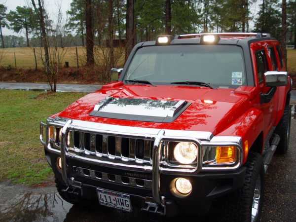

i was washing the H3 today for the first time, and i noticed the water went weird places, the dealer recently fixed my orange roof lights...tell me if yours does this, thanks.
if u dont see the pics or somin let me know.
the red arrows in pic 2 & 3 show the path of the water.
^^^ is it supposed to be there?
^^^ what about tehre?
that last picture is sweet its all gone now. lol

what i mean was that they had just fixed the roof marker lights because of the noise and maybe put it on wrong, and i was wonering why there is water in all the door jams (between front and back door, etc)

The last photo (not the Candybar one ) doesn't look right. There shouldn't be a gap like that. My center marker light unit is completely flush with the pillar units.
I think this is the cause the water pooling in the door jam. I think you're going to have water leaks if it remains like that.

its not as big of a gap as it looks in the picture, but the other side is flush, and it did it there too, so idk..

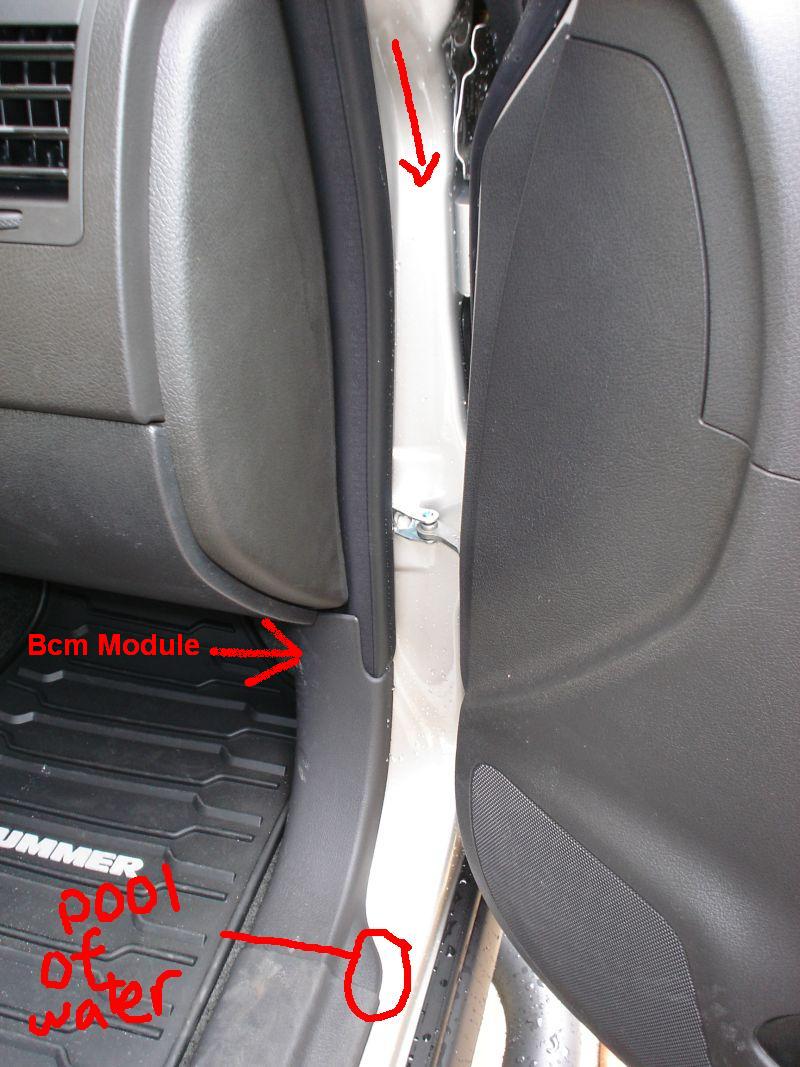

Well I can tell you from first hand experience that the water leak is headed rite towards the BCM module.I had the same problem they found a pool of water in the same spot.That leaked fried 2 Bcm Modules within a 2 week period I wouldnt wait around to get it fixed.They did finally fix leak and all is well so far.
