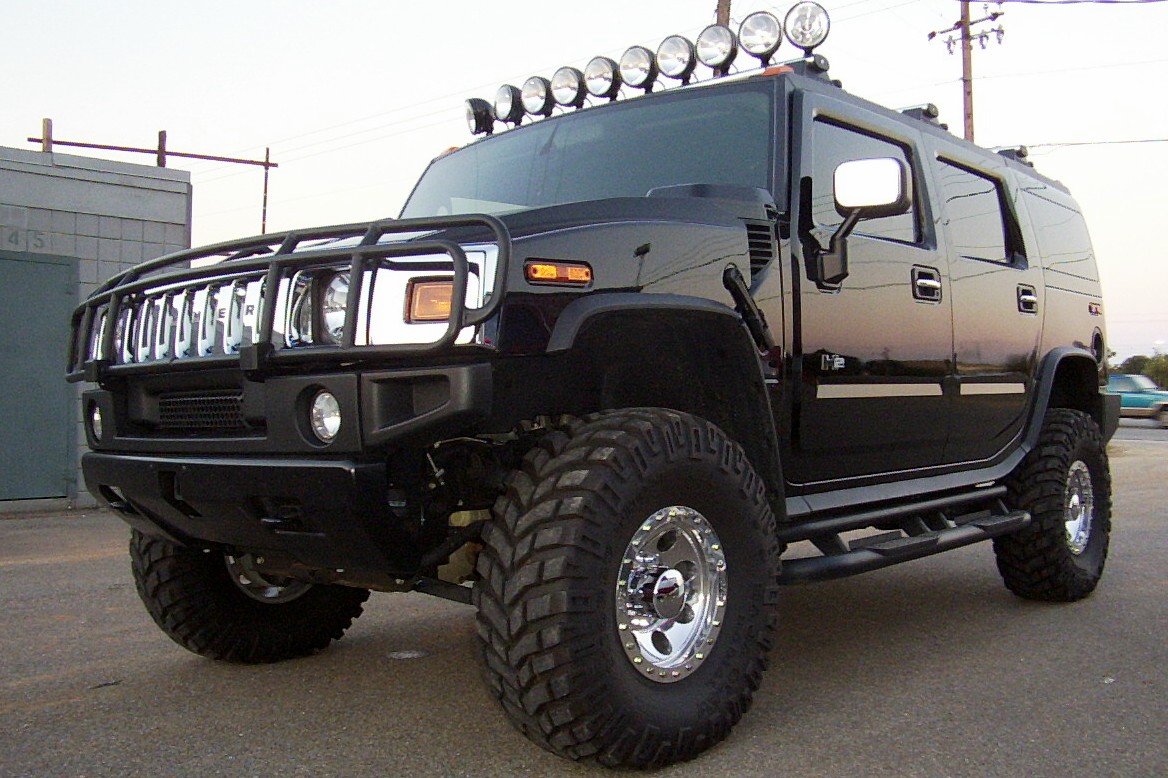

Just finished my light bar. What do ya'll think. I thought about 12 Daylighters but I just could not fit um.

 I think you need to get back on your medication as soon as you can. If those fixture are anywhere close to 50 watts each you will need an AUX battery. I sure hope you ran 4 guage wire direst to the battery and that the switch is on a 100 amp relay.

tho i somehwat doubt that u will have a battery after 5 mintues of use.. i have to say THAT IT LOOKS INCREDIBLE
everything that i would do to mine if i had the cash. the rims are nice and id love lighting up the town if i had those lights  props..

Ten 100 watt 200,000 candle power KC daylighters. They draw 6.9 amps at 14 volts (measured by me). Thats 69 amps. Ran 80 amp pac constant duty relay thru a 100 amp circuit braker. Those numbers indicated 6 guage wire was necessary. Thats what I've got. Works fine stays cool. Alternator output is at least 120 amps with heated seats. Battery still shows charging with factory lights, a/c, radio and light bar on.

Any good light guy will tell you to run with a 15 to 20% extra capacity. Thats why i said 4 guage. Just run them for an hour straight and then inspect the wireing. If all is well and the wires nearest the battery are not 20 degrees or more above ambient air temperature you will be okay. If they are getting hotter you are getting to much DC resistance.

I have not run them an hour yet. I'll can all ways re-run 4.

HM. re ran 4 guage today not alot of fun getting it thru the a piller.
PhilD Thanks. I know that it is overkill but so is an H2.
Longhorn thanks. My company built the lift kit. 3 1/2 front 2 1/2 rear. The claw is a brand new size 325/80/16 or measured height 37x13.50.
