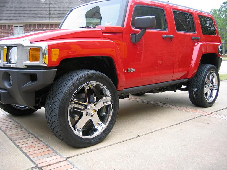

Old 11-27-2005, 12:25 AM
kram kram is offline
Posts: 26
kram is an unknown quantity at this point

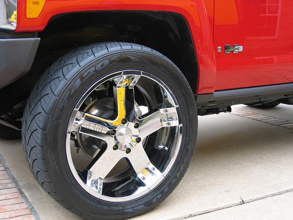

Here is one......................
Old 11-27-2005, 12:26 AM
Posts: 26

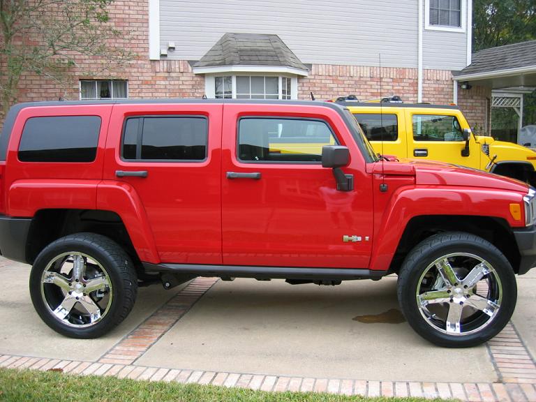

Here is another.............
Old 11-27-2005, 12:28 AM
Posts: 26
It is actually my son's Christmas present...... just arrived this week. Wheels are on, need the chrome side steps. I got some really nice Katzkin leather seats off of ebay. They get installed this week.

Want to adopt another son?? JK. Looks cool, though I'm probably not going with anything bigger than 18" on mine. This is one of the better looking H3/big rim set-ups that I have seen.

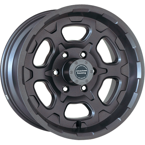

Old 11-29-2005, 01:48 AM
these will fit if you want an offroad tire
