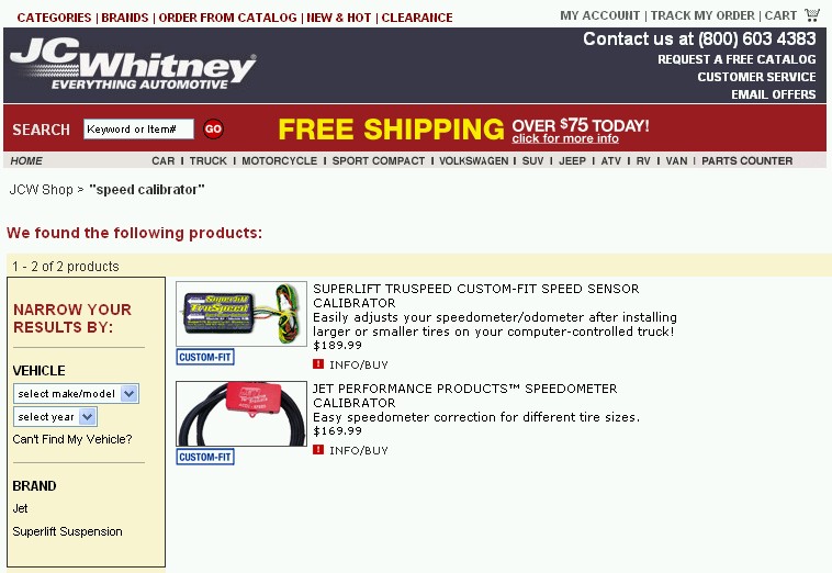

Here are a couple products from JC Whitney (http://www.jcwhitney.com/autoparts/S...&searchbtn.y=9) that do this function. However, the H3 is not listed for either product probably because no one asked either manufacturer to put the correct connectors on the ends.

My Dad forbids me from shopping JC Whitney, but if these work, do they work on any vehicle?
If so, which do you rec?
Thanks again!!!!
Thanks again!!!!
Here are some other ones (from a google search on speedometer recalibrator):
http://www.drivetrain.com/autotransc...alibrator.html
http://www.4wheelerssupply.com/catal...oducts_id/1762
http://fasttoys.net/shop/product_info.php?products_id=1...fd4907c687ad558f5 293
