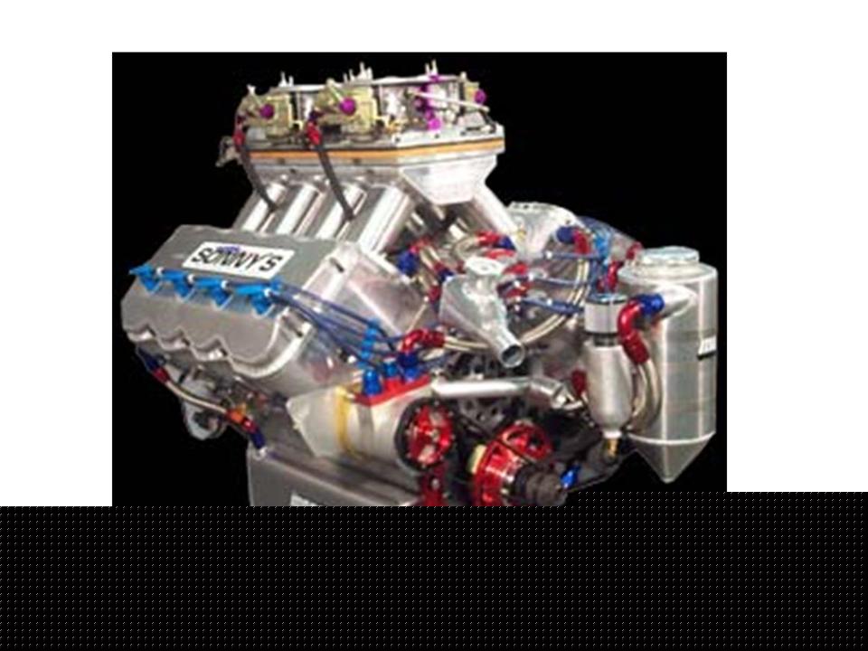

I'LL TAKE THIS ONE!
Next Generation GM Motor
815 C.I.
1600 Dyno HP (W.O. Nitrous)
Dual Dominator Carbs
http://www.sonnysracingengines.com/p...s/815-hemi.htm
