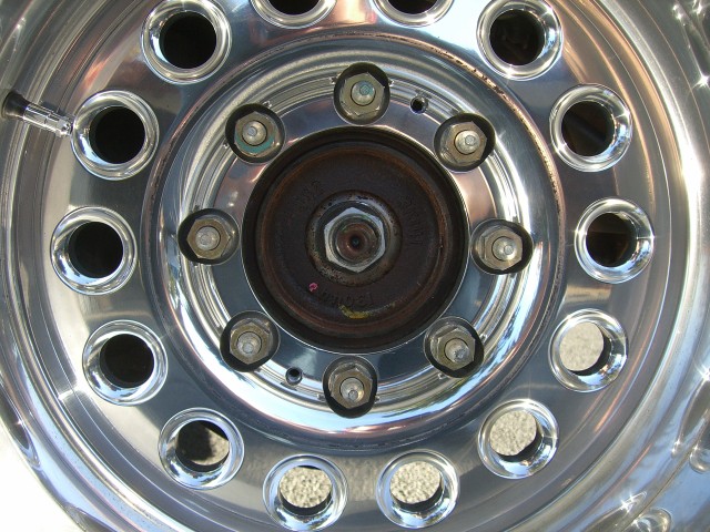

Old 02-14-2006, 12:13 AM
H2Finally's Avatar
Posts: 1,814
Ric, I checked on hubcentric rings, but no one has them in the correct diameters. Too large (130.1 to 116.7) for anyone to stock.
But I was told that I need a different set of lug nuts (a different taper than oem), which will work much better in centering them.
Also found out my pitman and idler are shot again. Alignment place recommended Moog (anyone familiar with them?). But I will try dealership first, to see if my extended warranty will cover replacement with stock parts.
Otherwise, the truck rides fine for now -- though with the additional rubbing, I'd prob change back to the old rims (& sucky MTRs) before off-roading.

Old 02-13-2006, 12:40 AM
Location: Charlotte, NC
Posts: 2,767
A lugcentric mounted wheel, as opposed to a hubcentric one, is potentially going to be more difficult to balance, but not necessarily so, especially if you can get them balanced on the truck.
What size are the rims, width, backspacing, etc? </div></BLOCKQUOTE>
Phil,
Have you seen the hub adapter that mounts on to a normal balancer which has fingers that goes into each hole simulating a hubcentric fitting?
Though my wheels are not a hubcentric fitting, we used that adapter. The other thing is, we got a better balance from doing a static balance on the machine that doing the inner/outer setup.
Mark

Old 02-13-2006, 01:53 AM
RIC-H0's Avatar
RIC-H0 RIC-H0 is offline
Posts: 2,605
Save yourself the guessing, and it should have the size marked on the backside of the wheel. You may also make sure you have the correct lug nuts!
The wheels look like they are 8.5" wide, because of the way the tire doesn't bulge(But it's hard to tell from a pic).
You should be able to go to your local big rig shop and have your tires balanced a shaved, once you have made sure they are centered on your hub. I would go to a reputable high performance shop, and ask them for the hubcentric adapters to try and get them, and keep them as centered as possible!
Good Luck!
Ric-H0

Old 02-12-2006, 03:04 PM
H2Finally's Avatar
Posts: 1,814
Close up, the wheel's center is larger than the hub on the H2; i.e. the wheels are held by just the 8 lugs. Is this ok?
Also, the stance is much wider than stock, even though the tire is same 12.5".
Can BLING Get You Home?
