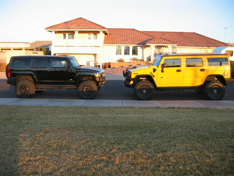

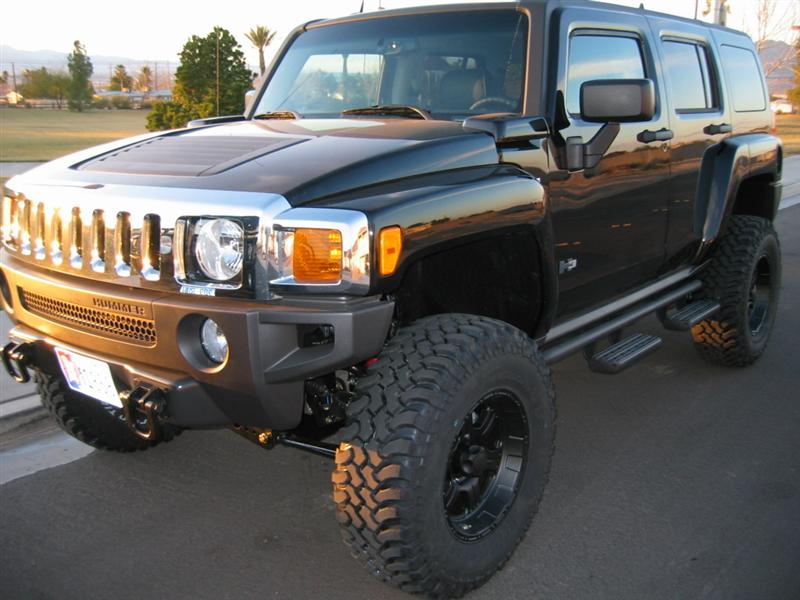

i read all your posts on the rancho lift and was considering waiting for the rough country to come out, but in the end i went with the rancho kit as well as a wheel/tire combo.
i have not expirienced any of the problems you had with your kit, handles great off road and on. and yes the 9000's are a great shock....
here's a recent pic

Posts: 310
HummerLV is off the scale
another

Old 01-31-2006, 01:47 AM
WTH? That was my truck! Same rims too.
Ok, so I need some info/ feedback please. You said you didn't have the issues I did. GREAT!!!! Two people that have had good luck with the kit.
Can you please check the clearance between that steering knuckle and your tire. What are the specs on your rims? Offset/ backspace?
couple more q's:
How does it handle? HWY and around town?
Are your bumpstops touching in the front like they were when stock?
Thanks for the input. Any plans on offroading it?

ok... thats just plain sick!
can you tell me what the specs are on those wheels and tires?! who makes the wheel, size, and tire info.
I was perfectly happy with just upgrading my tires and you had to post this. Now I'm interested in getting a wheel/tire setup!
Can you please check the clearance between that steering knuckle and your tire. <span class="ev_code_RED">about 1/2"</span> What are the specs on your rims? <span class="ev_code_RED">pro comp 7089 17x9</span> Offset/ backspace? <span class="ev_code_RED">4.75</span>
couple more q's:
How does it handle? <span class="ev_code_RED">feels great, nice and tight on both hwy and town</span> HWY and around town?
Are your bumpstops touching in the front like they were when stock? <span class="ev_code_RED">yes</span>
Thanks for the input. Any plans on offroading it? </div></BLOCKQUOTE> <span class="ev_code_RED">offroad, MOST DEFINATELY</span>

<BLOCKQUOTE class="ip-ubbcode-quote"><div class="ip-ubbcode-quote-title">quote:</div><div class="ip-ubbcode-quote-content">Originally posted by MarK M:
can you tell me what the specs are on those wheels and tires?! who makes the wheel, size, and tire info.<span class="ev_code_RED">pro comp 7089 17x9 4.75BS [COLOR:RED], BFG MT 35 12.50 17</span> [/color]

one question on those side steps. Are those the quick release steps for when you go wheelin?
I'm thinking of picking up a step. I do need the rocker panel though... correct?
Old 02-01-2006, 11:44 AM
DarthKarl's Avatar
Location: Cheyenne, WY
Posts: 809
DarthKarl is off the scale
Each side step is secured by two bolts to the rocker bars (which are required). It takes me about 5 mins to get all four of my steps off to go wheeling.
I'm thinking of picking up a step. I do need the rocker panel though... correct? </div></BLOCKQUOTE>
Darth is correct on install, very easy to take off
