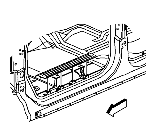

Old 04-22-2005, 12:44 PM
1. Firmly grasp and gently pull the front door sill plate to disengage the retaining clips.
2. Remove the front door sill plate from the vehicle.
3. Inspect for broken or missing retaining clips and replace as necessary.

Old 04-23-2005, 11:56 AM
So, what's up with the deal I posted above that is out of the SI manual?
Old 04-23-2005, 12:07 PM
Hummie2's Avatar
Hummie2 Hummie2 is offline
Location: La Porte,TX
Posts: 391
Hummie2 is an unknown quantity at this point
So, what's up with the deal I posted above that is out of the SI manual? </div></BLOCKQUOTE>
That is the inner sill. It pulls right up and it's a great place to route wires going from the front to the rear end of the truck.
Old 04-23-2005, 12:23 PM
Hell, I had to go look at my truck to see the difference. Wasn't thinking of 2 different sills.
