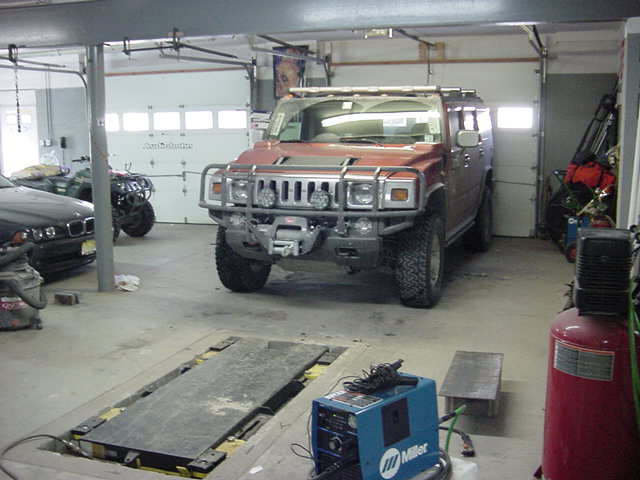

As all of you know, our T-case protection is good for a bird bath (when flipped upside down)  I seen our fellow H2 member construct a beefy skid plate out of some scrap U-bolts and metal and it sounded like a great idea. I went into my garage and gathered up the goods. This is how it went.....
The truck is in the garage waiting for a bath and some armor....

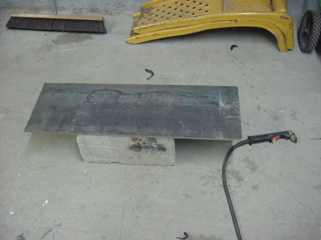

This is the first piece of steel. It is 3/16" plate.
Mike - Station 38 Fire Chief -

With a little help from the Miller plasma cutter, this piece gets cut to 9" X 21"

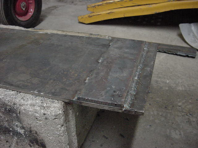

This is the first piece welded on the plate. It is about 3" X 9". This will help space the new skid plate another 3/16" away from the t-case when bolted on.

This is the top section of the piece that was just welded. The top plate is cut out for the OEM bolts. With the 3/16" drop, these are able to be counter-sunk so they will not get hung up.

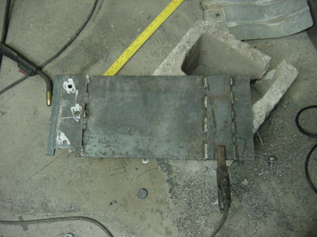

This is the bottom again. The second spacer plate is welded for the rear. This second plate will eventually rest against the torsion cross member.

This is the t-case side of the new skid plate. I also welded 1/2" X 1/2" square stock down the long sides for even more support.

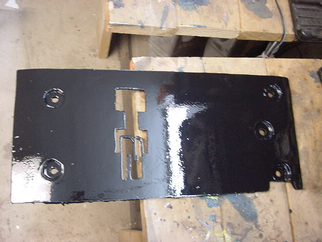

Since I was so bored, I had to get a little creative. This H2 cutout is for all the rocks and things you may run over. Now....if they miss the H2 stamped on the front skid plate, they will be reminded, very shortly, that they have been just ran over by an H2. You can also see the rear counter-sink holes.

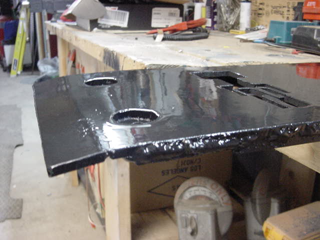

Its got some paint now... On each end of the new skid, I heated it up (red hot) with a torch and bent the ends. This gives the new skid plate a rise on each end so it tucks up towards the floor of the truck. Now the ends will not be able to get hung up.

This is the top view of the skid plate. It is still glossy because its wet! Its actually flat black primer. Now the explination on the mounting. You can notice the 3 holes with a notch on one end. This is the OEM bolt pattern for the front. The notch in the plate is to clear the other OEM cage under the motor. I only used 2 bolts for the rear. I drilled these 2 holes through the front side of the torsion bar cross member. The holes are drilled in the part of this cross memeber where it makes a small "U" shape at the bottom of the steel. The rest of the skid plate extends to the back part of the torsion bar x-member, to cover it up.
I will get some pics of this new plate installed so you can see the complete product. Hope you enjoy!

You've just created a weak point plasma cutting that logo. Excellent idea though.

Somebody likes to weld. Instead of adding all of the extra plate for spacing why didn't you use a press to give it a slight bend to accomodate the t-case?
Just wait until a rock scrapes across that thing and lodges in that cut-out logo. I'm curious who you think will be impressed by the logo way under there?
Don't take this wrong, I'm not bashing you at all.
S&B Member since '03<HR></BLOCKQUOTE>
Yes, a press would have beeen nice, but I do not have a press. It only took a little time to add the plates.
As for a rock getting caught....If that rock doesnt get caught up in the cage in front first, then maybe it will grind against the edges of the logo. If it makes it past that, it will get caught in the deep notch of the torsion bar cross member. Either way, I am not worried and/or concerned if it gets beat up, bent, or messed up in any way. There are not too many trails that I go on that have real "sharp and pointy" rocks sticking up down the center of the trail. If I ever decide to cover it up...1/16" plate welded over it....or what the hell...I can build a new one in a couple hours.

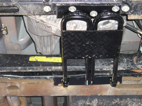

Did you tell N2ITNSD about his t-case protector? He may need to be warned of the "rock getting caught in your t-case protector". Check out the pic I have attached. Here is his well-built t-case protector (a fine job). As you will see he has the same problem...right? You will also notice the MANY OEM holes and crevasses throughout the bottom of the truck. There MANY places for a rock to get lodged into. Count how many are in this pic alone. Take a look when you get a chance.
Who will see this....mostly just me...and it makes me smile  Also, the dealer will see it when doing warranty repair...they may smile too. And it impresses me...thats all it needs to. Maybe it impress someone else out there in H2 land...
As far as a weak point with the H2 cut out....I can jack the truck up on that plate. Anything is stronger than the OEM free-hanging tin.

DRTY's reply is positive, just constructive questioning. You did a great job! Beef up the bottom of an H2 and you can go anywhere!
Even my H1's belly had some aluminum in there that now resides at a scrap bin I hope. Steel is the only way to go. I hit a rock so hard this week on my steel rockers that half the crap in my truck went flying in to the windshield. That's fun stuff!
