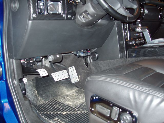

I'm looking for some ideas on were to mount my brake cobtroler? I'm like 6'3" tall and was thinking down above the gas pedal, but I thought I would see if anyone had a better idea. Thanks!

How about in the glove box or center console?

I thought of the console, but it has to be mount with-in -20 to +70* facing forward. I just hate to hang it under the steering wheel. I may just have too. Thanks

Do you just need to see it or are there controls on it you need to reach?

You really need to mount it where you can reach it. Heres a couple of pics showing where I mounted mine. I am only 5'11 but it works out fine for me. No leg clearance issues at all.

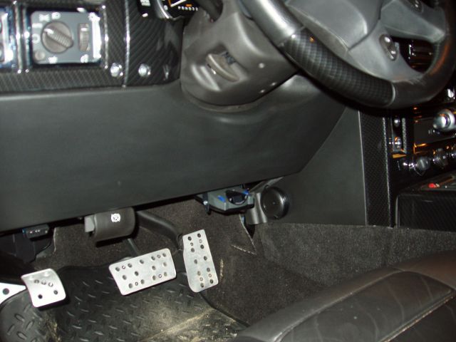

Pic 2

Thanks MSeeb for the picures, that helps! I think thats were I'll be putting mine too.

Well I have it all installed. I checked all the wires and it must have been the right plug. I ended up with it installed the same place as MSeeb. Thanks guys for the input!
