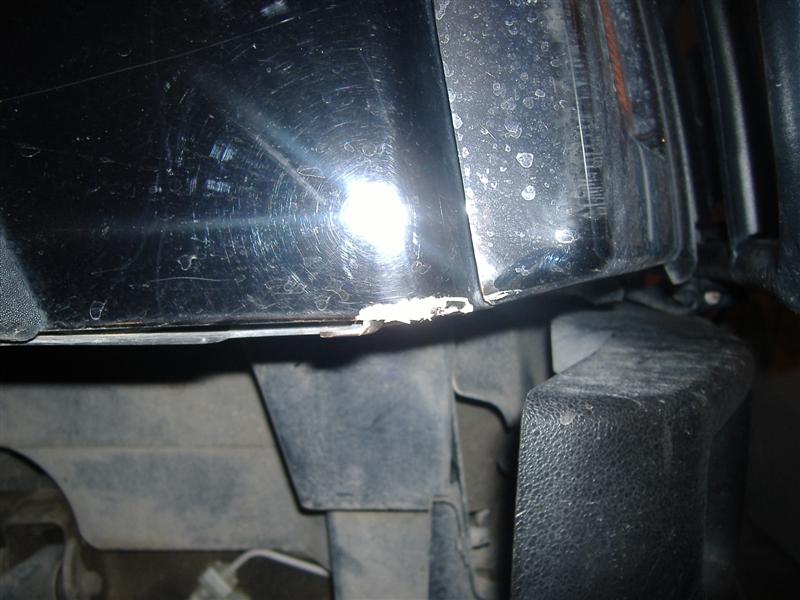

Ok, so, my uncle was kind enough to back into my H2 today. No worries...my wife had just pulled up behind him and he didn't see her....oh well...such is life. It's not a huge amount of damage (not like mike)...if it were just metal or plastic, I wouldn't worry much about it...but it's in the fiberglass. I've never dealt with stuff like this before. Spoke with drty, and I'll be taking it to the body shop tomorrow...Just wondering.... for you fiberglass experts out there...is this something I could do myself with some glue and touch-up paint? Or is it best to have the body shop take care of it...any ideas on reasonable cost? Thanks. (35hrs and counting........)

that looks like some bondo would work better. i have built sub boxes and other racks and mounts with fiberglass and bondo. looking at what you got there you'd probably need to sand the front edge, trim the fiber threads to clean it up then you can break out the bondo and smooth some on and mold it a bit. let dry then sand to shape and smoothness, clean then prep for paint. but again fiberglass and bondo suck.. but i have found that bondo CAN fix ALOT.. but its unfortunate because it does not look like you could just patch it easily yourself. it looks to require alot of paint and sanding. you might be able to get corners cut if a good paint guy can blend it instead of having to sand and repaint the whole hood..
on the other hand.. it could of been ALOT worse.. just cut from the fender straight forward and make your wheel wells even BIGGER!!! mold some custom flares and make it a baja buggie tubbed out h2..
it might be cheaper for the autobody guys to remove the hood and just strip the whole thing and fiberglass it and get it all perfect then just repaint. with the black it wont be that hard. hey you could even have them cut some custom hood louvers or make a custom cowl hood with all the fiberglass. maybe cut a hole and run a blower?? hope this all helps. best of luck.

Before you go to the body shop try this - go to a marine supply place. Buy some black gel coat repair. Follow the instructions - apply, let dry and shave off the extra with the scraper they supply in the kit. Keep building it up. I bet you would be satisfied with the result.
Looks like that might work...now to see if I can't get it locally...

Without including the bumper damage, a good idea is about 2-3 hours (depending on if it's cracked underneath) for repair. The rule of thumb for painting is approx. 250 per panel (eg. fender) You'll have some time to R&I (remove and install) items like lenses, latches, fender flares, etc.
You could figure if you took it to a bodyshop, you'd have about 400-450 bucks in it.
It should be about a 3 day repair from start to finish.
Hope that helps.
Mark
PS. If I wasn't in the bodyshop business and was going to try to fix it myself, you can buy what's called vette adhesion panel adhesive. It's a cross between bondo and gorilla hair, just finer. The problem is painting... it's not that some people can't paint, it's just difficult to paint without the proper equipment and place.

Sorry about your Mishap... No Bondo! The marine supply route is the easiest way to proceed. the correct way would be to Clean the rought damage out with a dremel and a burr bit. after that you would want to apply a mixture of Virgin Resin and Powdered fiberglass activated with MEK (methyl ethyl ketone) leave extra material on the repaired area so it can be sanded down to match the original shape. start with 220 wet dry sand paper and work progress through 600 wet/dry and you will end up with a smooth as glass surface. Paint/Gelcoat is your choice.... Hope this helps

Thanks for the tips and info guys. I spoke with two body shops, both quoted $280 for the work. One quoted $150 if I only wanted to paint the immediate area, and not the whole panel. I found the Gelcoat stuff at a local marine supply store. I think i'll be going the gelcoat route. The area is small enough that I think I can get away with it as long as I do it right. In any event, if I screw up, it'll just cost me $150 to repair according to the above quotes....

You'll be sorry if you don't paint the whole panel. The paint on your truck is basecoat/clearcoat. You repair the damaged area and then use the basecoat (the actual color of your vehicle) to finish over the repaired area.
Then you clear the entire panel. That way, if you blend the basecoat out a bit, you are not bringing color right to the edge of the panel and therefore no risk of a color mismatch.
If you try to "blend" out the clearcoat, you are taking the paint from roughly 4mils to nothing. At some point, if you buff or wax over this area, EVENTUALLY you will wear the edge of the clearcoat down and be left with an edge which will be noticeable.
Also, gelcoat is absolutely ridiculous as an answer for repairing that little bit of damage on a fiberglass fender. That is so overkill, it's not even funny.
I can't speak for the shops that wrote estimates but make sure they are removing ALL necc. trim. Masking off lamps, mouldings, latches etc will be a sure way for the clear to peel later.
I'll bet that if you look at the estimate, the bodyshop is not removing the grille, sidemarker lamp, latch, mouldings, etc ,etc... You'll be sorry if not.
