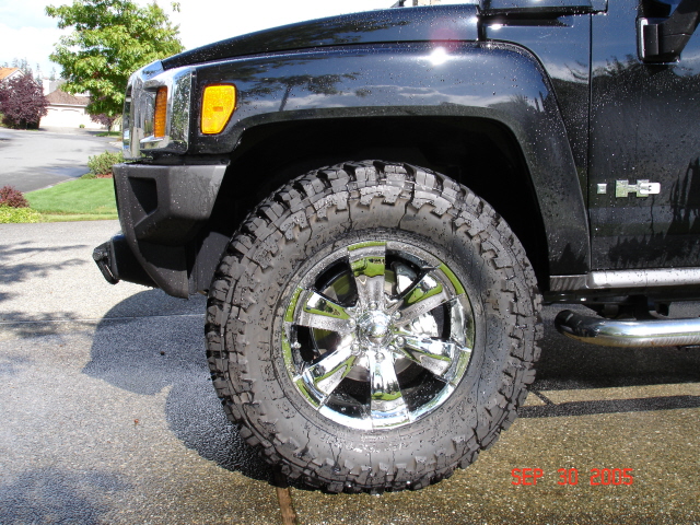

DUH !!! all this lift so he can install 285/75s ??? I've installed the 285s on stock suspension, and didn't even tweak the T-bar.
if you're gonna lift it, go all the way and put the proper 35 or 37 inch tires.
pics of my stock red H3 with 285s are in the "rim specs" thread.
