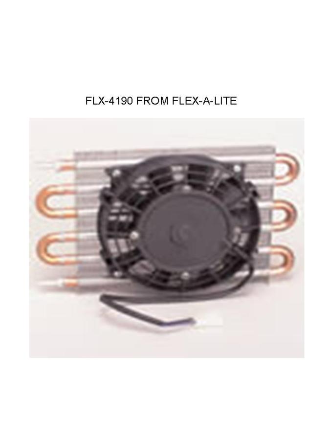

Old 05-17-2006, 03:34 PM
H2 Ranger's Avatar
H2 Ranger H2 Ranger is offline
Posts: 201
H2 Ranger is an unknown quantity at this point
Default Re: Transmission Running Hot
Heres one for you and there are others..

Old 05-17-2006, 03:37 PM
Fubar's Avatar
Fubar Fubar is offline
Posts: 8,750
H2Ranger, ya I was looking at those on-line last night. I'm just a little leary of anything made by flex-a-lite because of the troubles I've had in the past with there fans. In all fareness the fans were probably just fine it was just a crapy job of installing the control module that I believe caused my past problems with the fans.
Thanks though I will continue to look that option and others.
