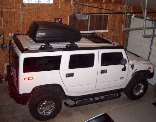

Does anybody have a roof mounted cargo box? I was thinking about getting a Thule 682 so I can leave the spare in when I travel. The only question seems to be will the ubolts that attach it to the crossbars fit the beefy bars on the H2 rack?

I have the "official" Hummer model (came with my used '03 H2... kept it!). It is a nice setup, and works well, if you choose to go that route. Hopefully, someone can answer the question specifically on the Thule...

The hummer one is made by Thule FWIW. I think the stock mounting hardware is 100mm u bolts. I don't have the catalog in front of me, but thats what I remember. Just go to you local Thule dealer or call the 800 number for Thule and they can get you all hooked up. I was going to do the same thing, but ended up sticking the tire on the rear. Yakima also makes a nice cargo carrier too, so you might want to check those out aswell.

I was under the impression that Thule does NOT support using their products with the H2 and the factory racks (even though they supply the Hummer cargo box). If you want to use their products, you're supposed to use their racks. If you want the U-bolts, you may just have to go to Home Depot...or, I thought that the cargo box was attached with smaller bolts to the inside rail of the cross racks..?

I got the bigger one! I need to get longer carriage bolts to make the hardware work though.

After messing with the brackets for hours I finally figured it out. Just take the end of the roof rack off and pull out the rubber piece, then you can slide some carriage bolts in the track and just bolt the cargo box to the rail. Geez!
Thats exactly what I did with my Thule box and no problems. Thousands of miles with it up there and all is well
