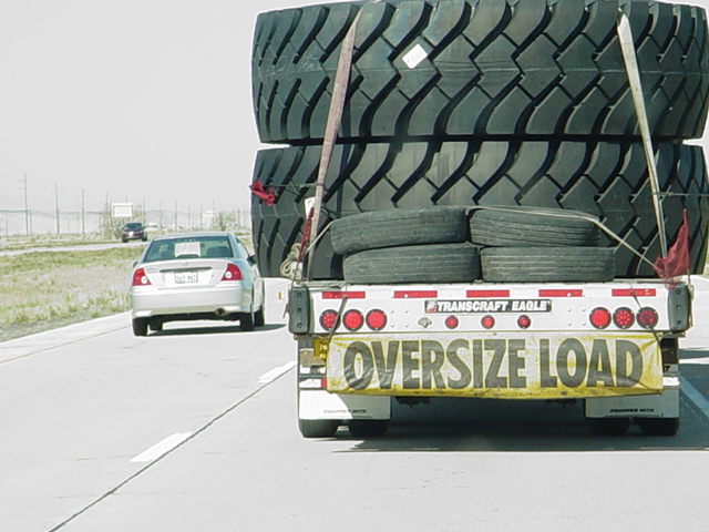

Im trying to fit these on a H3 and not havin any luck
Old 07-08-2006, 03:45 AM
Default Re: Best All Around Tire?
Maybe if you crank the torsion bars one more turn
Those are Michelin 40.00R57 XDC Earthmovers. It's going to take a lot of crankin' on those torsion bars to get those to fit!

BTW, those on the back of the semi-flat bed were my mine, I did a test fit and found they rubbed slightly more then a I cared for at full articulation. But man they looked killer
