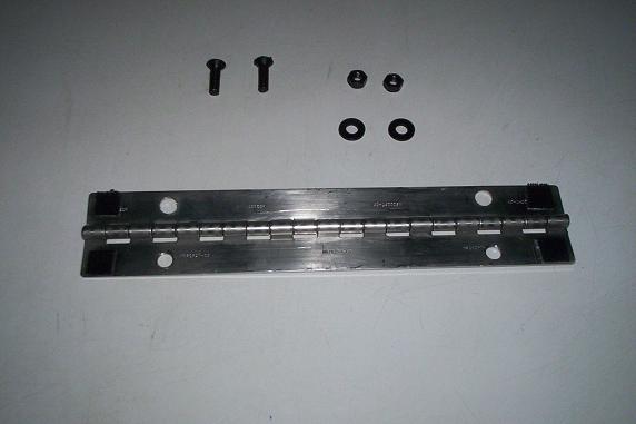

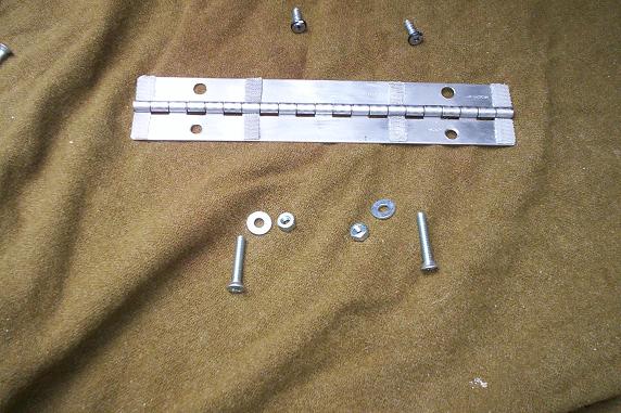

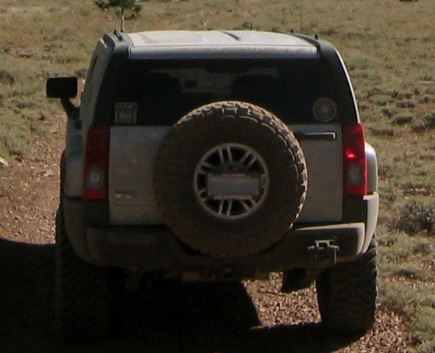

I started working on a hinged rear licence plate.
I had to use a grinding wheel to flatten the factory screws a bit so it would close flush.
I have cut a piece of piano hinge to 10 1/2 inches
Drilled holes into it and have 2 tapered screws to mount plate.(I will cut them down to size and paint black.
I wanted to use a magnet so it dont flap in the wind but stainless steel is not magnetic .
I ended up using 3M interlock.

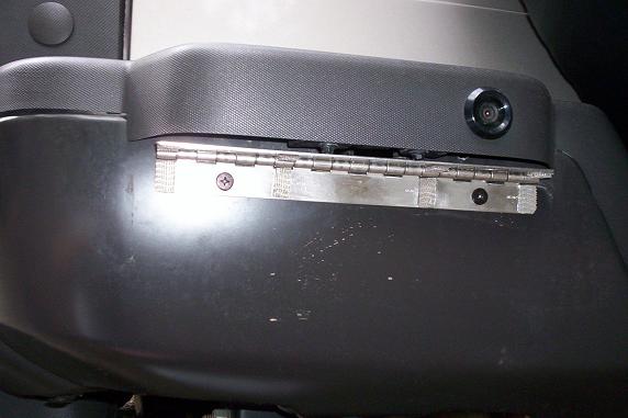

I mounted it and realized the 4 1/2 inch pieces are not strong enough to hold plate from flapping.
I will go get some more and put a 1 1/2 inch piece on both ends and a 4 to 6 inch piece in the middle.
My wife went back to work with the 3 and Im leaving to go upstate as soon as she gets home so I will list final results next week.
I noticed a bunch of you here mangled your rear plate
Pic with it attached to bumper

Magnets do not work with stainless steel
I bought 3M dual lock Hi Strength Hi temp superlock fasteners Very strong only needed 4 small squares.(much stronger than the clear stuff.
I will put plate on when wife comes home and then upstate I go.
I dont think I will need it this time around,but you never know.
I will list pics of install when I get back.
Removing front plate is a must,I snaped it off in Georgia backing off a hill.

Thats what a power washer is for
Any other ideas.
Magnets wont work
cabinet holders ? glued on snap ? pop out retaining clip
only 1/8th inch opening
I will keep my eye out at home depot

Intelock is plastic on both sides and snaps in tighter than velcro.
Its what they give you with EZPASS .
Only a small piece is needed.
I was going 80mph for a while and hit 90mph and the plate stayed in place.
A little tug pops it off and it swings back,its one off those things that you dont need it till you need it.
Low cost insurance from damaging plate/plate frame or mounting nuts.
I will post pics tommorow of the hinged plate installed and at 90 degrees flaped open(wife took the 3 today )

I have that plate bracket on the 442.You would have to drill into the H3 bumper.
Interlock works fine I ended up using 1 piece 1 1/2 inches long in the middle(didnt like snapping it 3 times) snap and its secure.

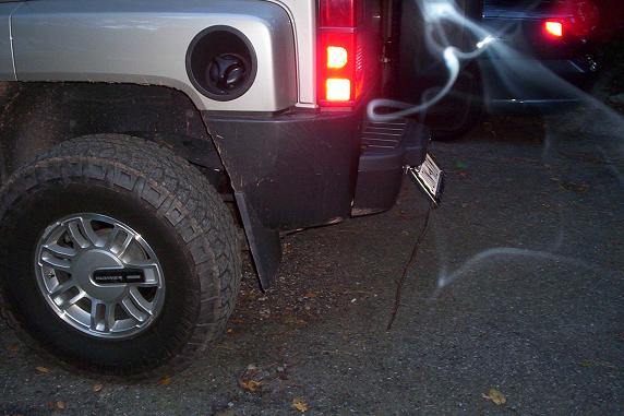

final result

45 degree angle

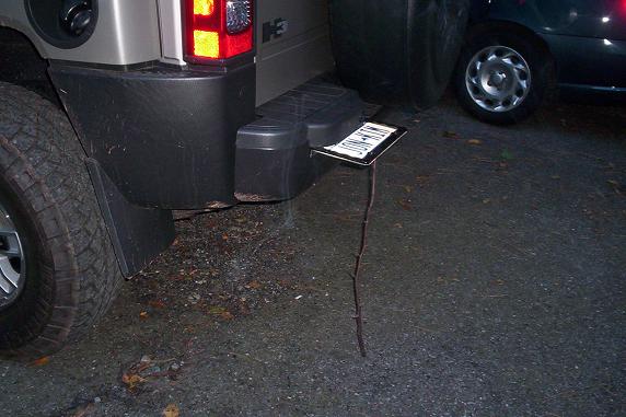

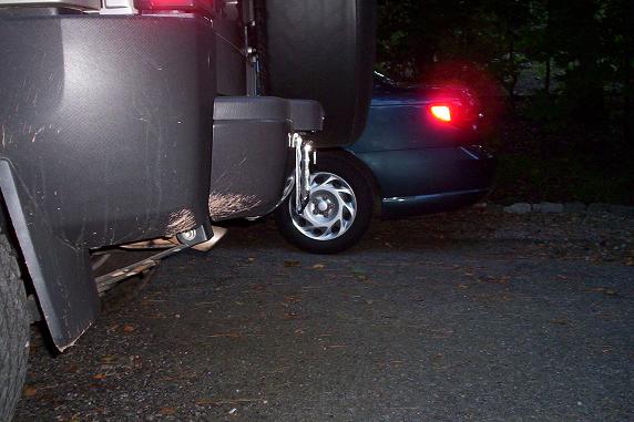

Old 08-22-2006, 12:22 AM
fourfourto's Avatar
Default Re: Hinged rear licence plate
90 degree angle.
