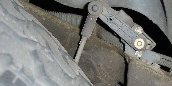

Can someone post a pic of the sensor location? I've looked under there a couple of times, and can't really figure out where it's at...

Default Re: can the sensor for the air ride be tricked?
Originally Posted by PhilD
You can't miss it, it is the only thing connected to the frame in the rear wheel well.
I don't see where they can be adjusted, guess I will take a closer look after some more coffee. I know my friends H2 seems to sit almost an inch higher and she doesn't have air suspension.

Old 09-09-2006, 08:10 PM
dochummer's Avatar
Location: Eastern Washington
Posts: 2,453
Ahhh..was wondering what the h*** that was...

A while back SteveR told me that he and some others put some kind of "spacer" to fool the sensor in thinking it's lower than it is. I don't have air ride, so can't offer more than that

Yetti Yetti is offline
Location: Grass Lake,Mi
Posts: 583
from looking at it you would have to make the rod longer to get it to respond in making it higher. it would effectively push the arm up making it think the vehicle was low
Posts: 583
as for shimming the switch you could add washers to the switch on the far side to rotate the body of the switch towards the arm of the switch. I would think one or two small washers could add an inch or two to the ride height
