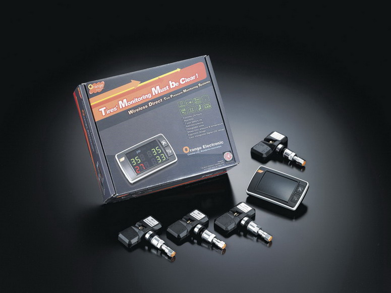

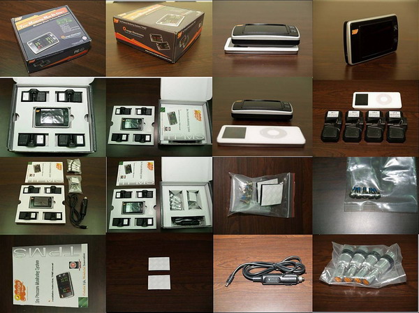

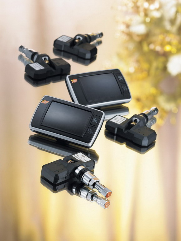

I also got Orange TPMS in my car, it is nice. they are using "TP-checker" as their retro-fit TPMS brand, and oec as their OE replacement sensor.
They have a formula team for Formula Nippon this year in Japan, and very good score for the racing.
it also showing the good quality product in the formula racing.
I love it in my car now.
More important, i love it, because it response very fast, i tried to deflate the tires, it show alert within 3 seconds everytime, very good.
