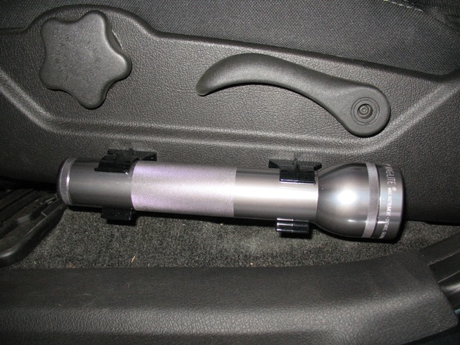

Here's something simple I did that I think will be really useful. I bought a pair of Maglite mounts and installed them on the driver seat, so I'll always have a flashlight handy.

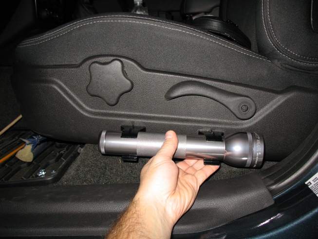

First, I put the brackets on the maglite and tested for size and placement. I chose a 2 D-cell model, but you can see there's room for a 3 or maybe 4 cell if you want. The maglite has a 3 watt LED and is super bright.

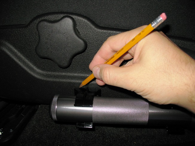

I carefully held the maglite in place and marked around the brackets with a pencil. Shows up nice and erases when you're done
Then I took the brackets off the maglite, placed them inside the marks, and marked the pilot holes.

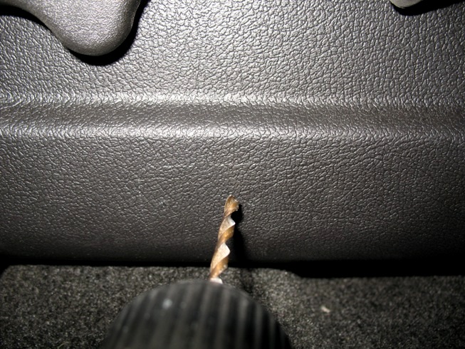

Next step was to drill out the pilot holes. There are some wires under the seat but not attached to the plastic, so I just went slow and easy. The pencil marks show up better in real life, but you get the idea.

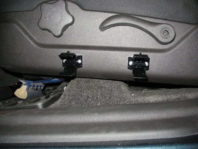

If you try and thread a nut and bolt like I did, move the seat forward or back so the floor bulge isn't in the way.
And there you have it ... two maglite brackets.

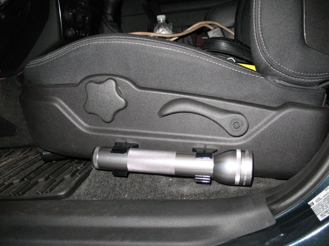

... and here it is with the maglite.
10-08-2006, 03:54 AM
Location: Arvada, CO
Posts: 1,139

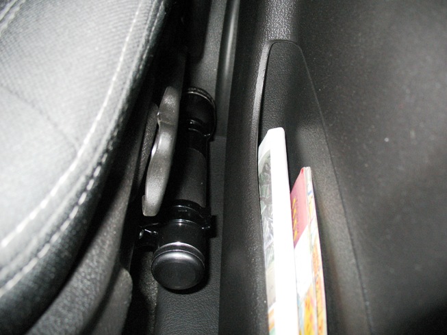

Re: Maglite install
One more pic to answer any questions about clearance. This shot is from the front of the seat with the door closed. There's between .5 and 1 inch of clearance from the door. No problem

10-08-2006, 04:59 AM
Re: Maglite install
Nice!!!
