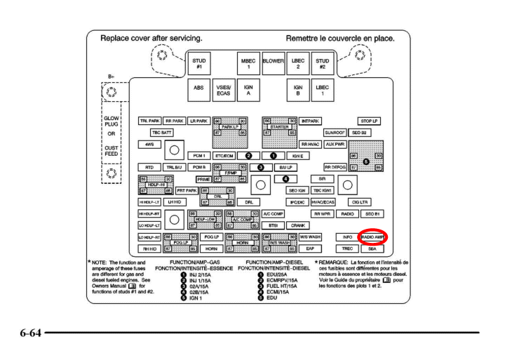

02-26-2005, 11:52 PM
There is a fuse in the fuse box under the hood that says radio amp. It is next to the blinking red circle in this pic
02-26-2005, 11:56 PM
Posts: 79
didn't pay close attention to door chimes. but i hit the on star button to make a phone call and did't here anything but the radio did turn off. Am i suposed to here anythiing when i push that button dial tone persons voice?? never used on star before so i don't know what to here thanks for the help paragon i am going outside to check the amp fuse under the hood been procastinating due to the could weather
Sorry, I guess I should have made one with the circle blinking around the radio amp fuse. Maybe this will redeem my laziness.
02-27-2005, 12:08 AM
Posts: 79
Ok Husband went out to take a look at the FUSE Box.. There was a BIRDS NEST in there!!!  Guess even the birds have good taste in vehicles!!!
He is out there right now checking the fuses...
02-27-2005, 12:28 AM
Posts: 79
okay checked amp fuse was ok can an amp go bad jut like that. will have to take it to the dealer on monday to get fixed. unless any one else has ideas.
