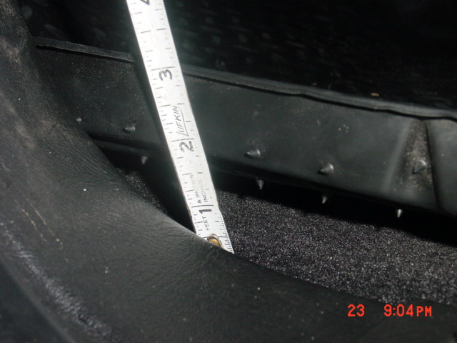

-Pic 1 shows how the kick panel protrusion causes the floorliner to be raised roughly 1-3/4" to 2" off of the carpet.

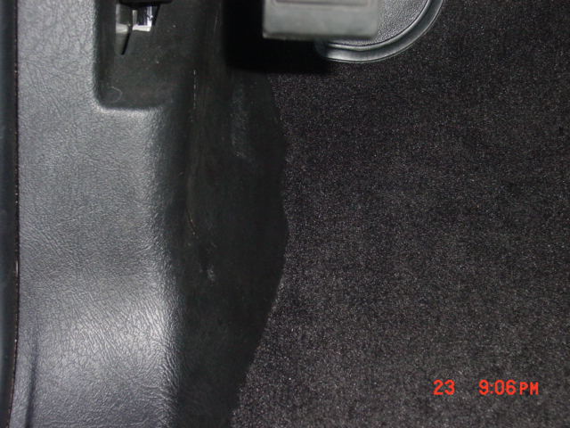

-Pic 2 shows what the kick panel looks like and you can see the worn area where the floorliner rests upon it.

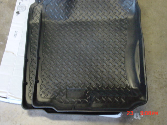

-Pic 3 shows a side-by-side comparison of the floorliner I purchased and the Engineering sample that you had sent out. You can see that they are identical even though the one you sent had apparently had attempted to be modified. The best option is going to be to raise the "floor" in the area where the kick panel causes the issue and not try to go around this area; as the kick panel's protrusion is of a "ramped" protrusion.
If you would also remove the entire area that is there for the Tahoe Manual Floor Shifter since the Hummer does not come with this as an option. I hope you can find this is a do-able option as the Kick Panel issue should be enough of concern to justify the H2 having it's own uniquely designed floorliner.
In the Floorliners current state, you have to push down on the floorliner to make it go flush downward with the carpet after entering the vehicle. This causes the side-wall to bend over and would allow liquids to pour out of the liner. It also tends to rise upward on it's own because of the kickpanel and is causing wear on the kick panel as can be seen in the photo 3.

Here is the email I got from Husky today:
I stopped by the Hummer dealership on Friday after Thanksgiving and the 2006
H2 is definitely different than the 2005 H2. I had an Engineer check this
part and they told me it was the same except for the run-off on the kick
panel (the area I had radius on the part). They also indicated that the wall
along the kick panel was snug, so I had that moved .350 inward. However,
this does not make the part fit. We will have to make a different tool to
accommodate all the necessary changes.
