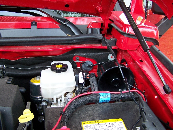

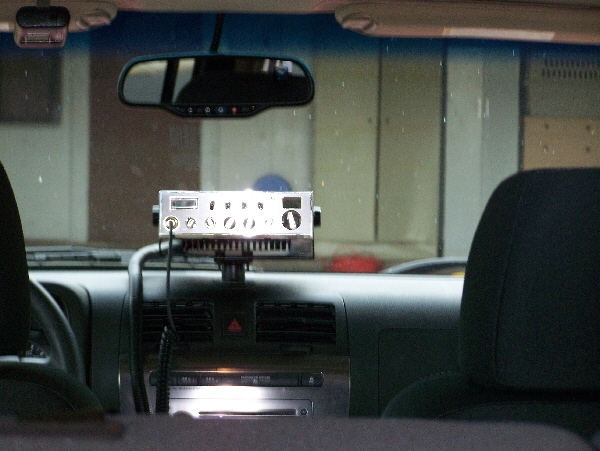

I have included a few pics of the installation. I used a lowboy mount on the dash so this is a temp/perm installation. That should leave room for the other units under or beside the dashboard. I also included the installation of the PA under the hood. I think I will wait to relocate the coax when the other radio arrives. I will be seriously looking at your suggestion for the dual bander. I will keep in touch for sure.
