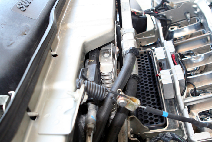

  • I replaced the stock water radiator with a much larger aluminum one from BeCool ($800). This radiator includes the transmission oil heat exchanger. After replacing the radiator the water temperature never once budged from 210, however the transmission fluid temperature still rose to 230/240

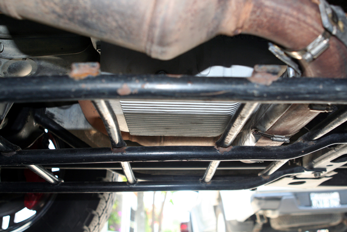

  • After reading carefully the description of PhilD ( http://www.*******club.com/tech/tranny_cooler_2.html ), where it seems that the solution given did not completely solve the problem, I decided to replace the stock transmission cooler with the largest one that would fit between the supercharger radiator and the air conditioning radiator. After extensive research, I chose the Tru-Cool MAX transmission cooler #4739-1 (without the external thermal bypass - Bulkpart.com $105). This transmission cooler is much larger at 8 1/2 x 22 3/4 x 1 1/4 inch than the Hayden 405 (10" x 15.5" x ??) installed by PhilD. I also replaced the stock transmission pan with the larger pan PML-9427 ($170 from Trail Duty) and installed a heat shield to cover the upper part of the exhaust as it passes under the transmission pan (THE-11630 Summitracing.com). After all these changes, the transmission fluid temperature fluctuates between 150 and 180, but never rises above 180.
Obviously all this costs, but I no longer have to worry about overheating problems!
I attach a photo of the installed transmission radiator and another of the new pan and exhaust heat shield.

MB, where did you get the heatshield from?

Heat shield was obtained from Summit Racing:

Michael, not to change the subject but in the picture I can see your hood cable with the rubber tube or "coating" on it. Those tend to hold in the moisture thereby corroding the cable causing it to break. Can be kind of a scaring moment...The new replacement cables don't have the rubber on them.

Mine were literally "white powder" inside after they broke.

As Phil can attest, mine are still in good shape because I spray mine with some anti-rust lubricant I use for everything.
