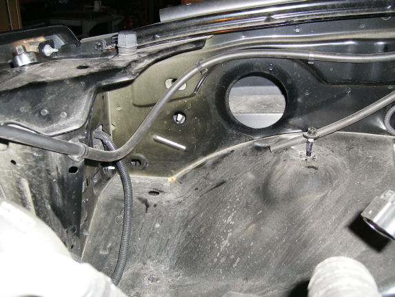

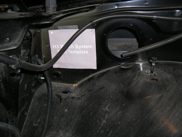

Inner Fender where the remote control box will be installed. The airbox has already been removed
http://www.elcovaforums.com/forums/attachment.php?attachmentid=34989&stc=1&d=11683090 37
Here is the template that is used to dril the holes that are used to mount the contro box. Note that you only have to use three of the holes. I also had to use a longer bolt in place of one of the factory bolts since I placed the box very far forward and there is a hump on the inner fender wall.
http://www.elcovaforums.com/forums/attachment.php?attachmentid=34990&stc=1&d=11683090 44

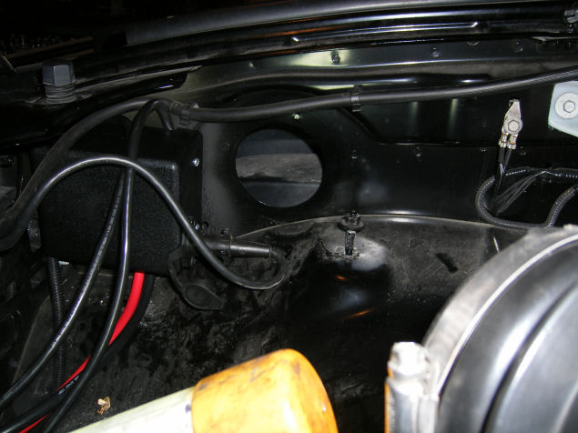

Now here is the control box mounted under the hood. The remote control cabel is there but it will have to be installed as part of the new bumper and the little "ears" will have to be cut off to fit thru the hole on the bumper. All the holes were painted before the box was installed to prevent any rusting.
http://www.elcovaforums.com/forums/attachment.php?attachmentid=34991&stc=1&d=11683090 50

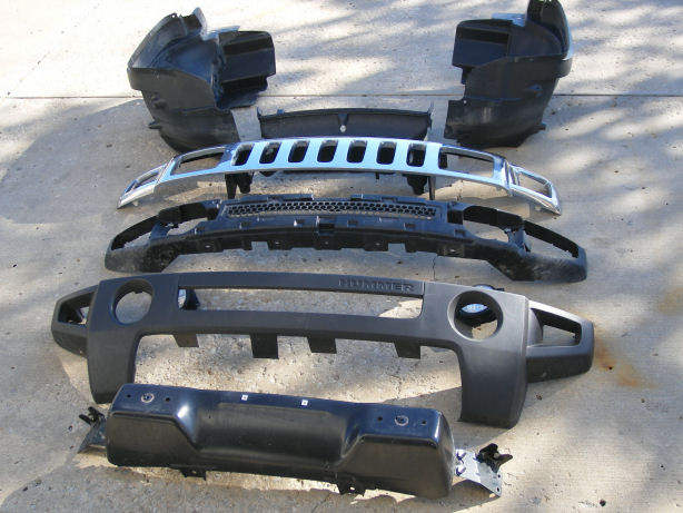

The disassemble is layed out on my driveway. There is also an air duct component that is in front of the radiator that will not be re-installed since there is no longer room for that part.
http://www.elcovaforums.com/forums/attachment.php?attachmentid=34992&stc=1&d=11683090 57

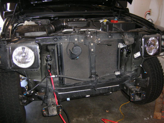

Here's the front end getting ready to thread the cables to the battery. They go behind the remaining plastic component in front of the radiator.
http://www.elcovaforums.com/forums/attachment.php?attachmentid=34993&stc=1&d=11683090 63

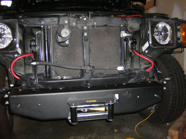

Here's the bumper set in place an the cables routed.
http://www.elcovaforums.com/forums/attachment.php?attachmentid=34994&stc=1&d=11683090 75

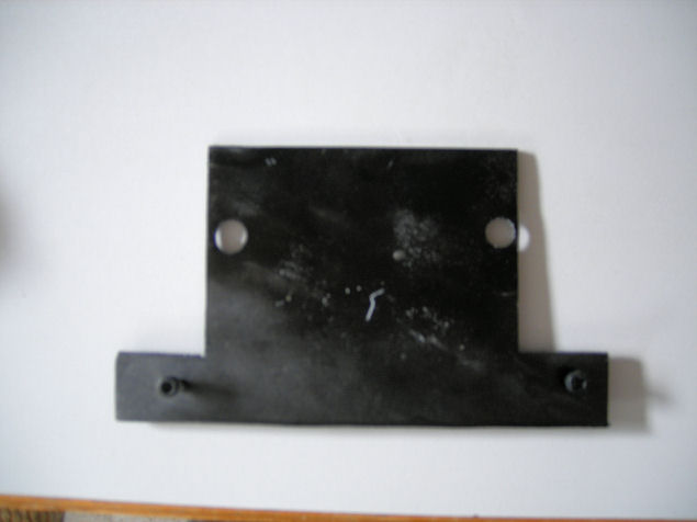

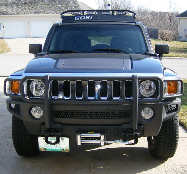

Since I live in a state that requires a front license plate, and I am adverse to getting tickets from our friendly state patrol, I need a way to be "mostly" legal and "display" a front tag. So I created a tag mount out of some plate. This mount was installed between the grille guard and the tow hook plate. I welded nuts on the backside and used stainless steel cap bolts to afix the plate. This will let me easily remove the plate during off-road excursions.
http://www.elcovaforums.com/forums/attachment.php?attachmentid=34995&stc=1&d=11683090 80
And so finally (after about 7 hours) here is the final product!
http://www.elcovaforums.com/forums/attachment.php?attachmentid=34996&stc=1&d=11683090 88
