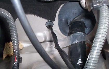

If your putting the camera in the back just run the wire thriugh the interior(you probobly dont have to remove panels just tuck them in)
There are some trailering wires in a cluster just above rear bumper.
If you have a wire that needs to go through the firewall,theres a grommit on the drivers side that you can get a wire through.(its easy if you have a 6 inch coat hanger wire to get it through and tie on and tape wire needed to it and just pull it through.
I seen others here mount the monitor in front of drivers side piller,Im sure you will see some pics if you use search. Good luck list some pics of install
Picture of the grommit I went through
