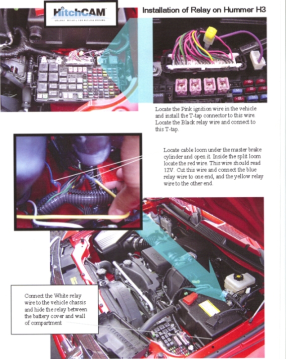

The HitchCam comes with a relay. The instructions say "If the HitchCam is going to be installed on a GM vehicle that is not driven regularly [like an extend stay in the field or sitting at the airport], there is a risk of battery drain ... [and] we recommend the installation of the ... relay kit."

HitchCam got back to me really quick. They sent me a specific sheet for the H3 with wire locations and colors. (The sheet I originally had was for the H2.) Also, the relay kit should be used as the the unit is constantly drawing power even if the monitor is switched to only display an image when reversing. It looks like the relay cuts the power to the (red wire at the) trailer hitch socket when the ignition is not on. Otherwise, the socket will always provide power.

Good info F5 and Steve. Here is that instruction sheet if anyone is interested in the mod they suggest.

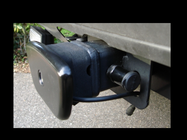

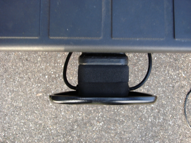

Default Do you have this much of a gap between your HitchCam and receiver?

Default Re: Did you use the relay with your HitchCam?
I just looked at my Hitchcam and it's the same as your pictures.

I had to use two foam spacers. It seemed odd to have to do so. The HitchCAM seems to be expecting the locking pin hole to be further back. I sent HitchCAM an email, so I'll let you know.

Ok, I'll await your feedback from them. My Hitchcam was installed by the local dealer.

Steve, did your local dealer
- use two foam spacers or some other extended/bigger spacer?
- add the relay (like above) to shut off power to your hitch when the ignition is off?
- my HitchCAM has a slightly amount of play in the receiver. I was thinking of stuffing some additional foam inside the hole to eliminate this movement. Do you notice this play in your installation? Does it have any effect on your image when in motion in ACC mode or cause noise/rattle?
MB,
  • Looks like 2 spacers, just like your pictures
  • Don't know about the relay, but I've had no battery problems
  • No play at the receiver. No image problems, no noise, no rattle.

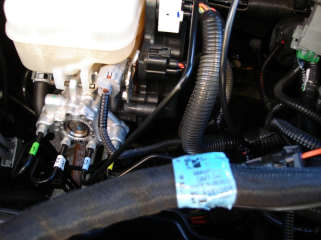

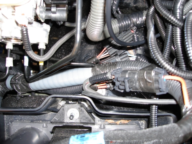

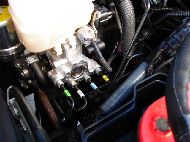

Default Which is the trailer hitch cable loom?
Any idea which is the trailer hitch cable loom?
Do you know how many wires (4, 7, or more) it contains and the colors of the wires?

Old 01-20-2007, 08:20 PM
fourfourto's Avatar
The trailer hitch wires are in the back above the bumper on the left side in a cluster,I beleve there are 7 wires.open rear hatch ,there under the lip .

Old 01-20-2007, 11:04 PM
mountainbiker mountainbiker is offline
Posts: 297
mountainbiker is on a distinguished road
Thank you Fourfourto. Unfortunately, I need the wire loom containing in the engine compartment by the fire wall as I need to install a relay to kill the power to the hitch when the ignition is off. (See the HitchCAM instruction sheet in my earlier post.) My Service Manuals (vol 1 and 2) don't reference the trailer wiring.

As for the wire,use a positive wire(off accy plug or in the cluster to right of the wheel towards head unit )and use a relay to power it off a keyed power,the yellow wire going to the rear wiper switch works with the key fwd and back ,run it to coil side of relay use the 12v power wire on the other side.
The relay comes with a diagram.
