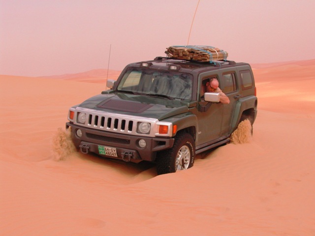

Hang on a minute - if you press and hold the button for the 3 secs or whatever it is, the DIC flashes with "STAB SYS OFF" right? (Auto trans I'm talking about...)
Now, at this point are BOTH the TC and Stabilitrak off, or only the Stabilitrack switched off?
I switch mine off all the time when we hit the desert otherwise it gets a bit annoying - 4 Hi Lock in soft sand - wheels spin and are slowed down etc... I have to say, it feels as though the TC is off, but the central diff working well to maybe give the impression of TC ???? Also, when STAB SYS OFF, I've had the car in powerslides in mud (I know, need to grow up ) - that ain't gonna happen with TC is it?
F5 - definitive answer please?
