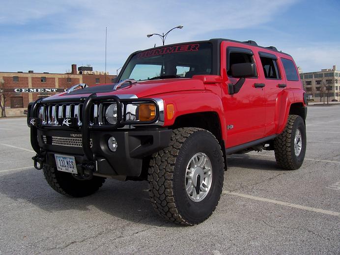

Pro Comp is running there buy 3 get 1 free deal again. Not a bad deal. I got the 315/75R/16 Xtreams for 807$$ (4 tires) delivered freight 2 miles from my house from the east coast. Cost a flat 75$ to ship them so the price for the tires was 732$$ Not a bad deal for 35's, Really like the preformance of these tires. Hes a pic.

Posts: 2,092
StarsnBars -
Did you have the 33's on long enough to notice any difference between them and the 35's in daily driving?
Also, do you have the XTerrains or the Xtreme All Terrains?

Old 03-01-2006, 04:38 PM
Stars, yours do look great and I too would be curious about the difference compared to stock.
