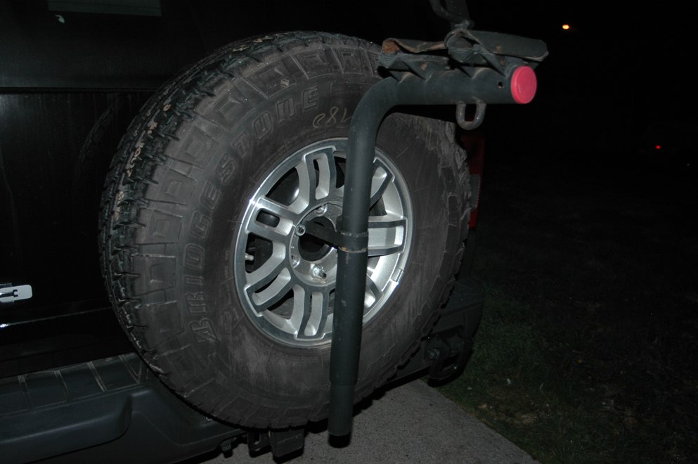

Here's what I did, since I didn't want to have my bike on top (building a roof rack, plus I lost a Trek 930 to a carport years ago). I also didn't want to open the rear hatch, then open the bike rack just to get to stuff out of the back.
I took my old hitch bike rack and cut off the top part, the vertical bar + the bike mounting points. It was a fold down, fold away Smittybuilt. I then welded on a mounting strap that bolts to the spare tire mounting bolts.
I bolted down the newly made bike rack mounting strap using the keyed lug nut, so someone couldn't steal the bike rack (with the bike). Now I can carry two bikes hanging off the rear gate, I can still see, plus I have space up top for the roof rack.

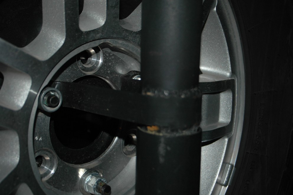

Here's a close-up of the mounting plate. Sorry for the blurry pic, kinda dark outside.

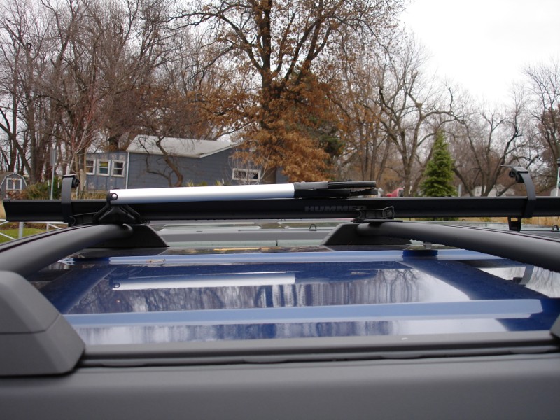

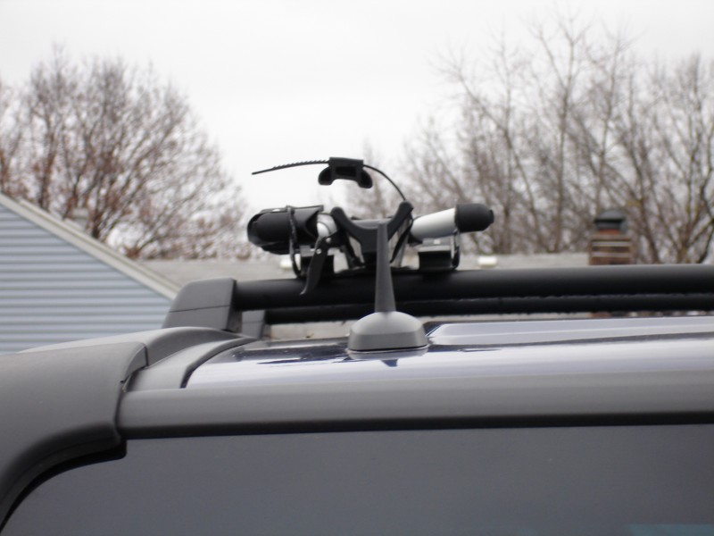

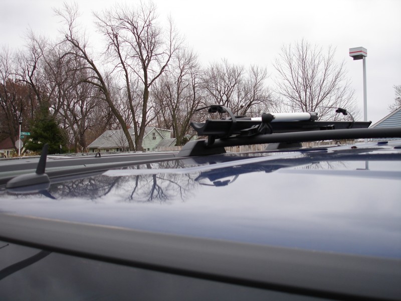

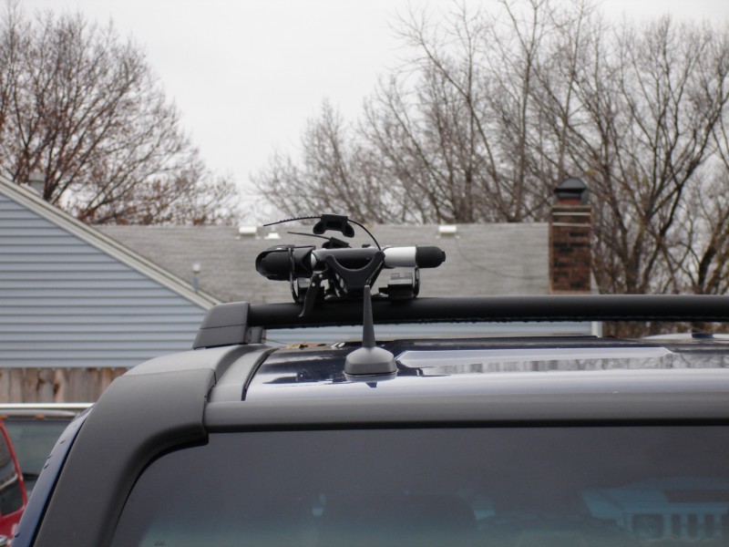

Here are some pictures of the Factory Hummer Bike rack that is the Frame Clamp Type. I tried to get a good angle on it to show it in comparison to the antenna. It is very easy to put on, the only trouble is mounting the bike. It is hard to get the bike up to the roof on your own without banging into the vehicle. As a Two person job it would not be hard but there are plenty of times when I have been out riding on my own and I do not like it then.

Pic #2

Pic #3

Pic #4

HoKC thanks so much for taking those shots. That is exactly what I was looking for.
I didn’t plan on getting the frame mount rack but after seeing yours I may change my mind. It looks nicer than the fork lock version.
You mentioned that you were having problems getting your bike on the roof. Do you have the side steps? If not do you think having them would help.
I have a custom Merlin XLM Mountain bike. It weighs just a little over 19lbs. Lifting its not going to be an issue but since I’m only 5’9 that may pose more of a problem.
In this pic would you say the space between the green lines is less than 7 inches? That is my max tolerance for the garage.

Any fears of the rear tailgate denting? That is only sheet metal holding the spare on with a stiffiner pad behind. A buddy tried to put a 35 on the rear and it started denting and buckling (barley but noticeable) after a few miles offroad. It doesn't seem to be the best place for additional cargo.
