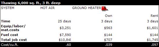

Try these guys CO.
http://www.groundthawing.com/?gclid=...FRJ_Ywodh1jGuA
$1500 sounds steep. The concept is basic so I couldn't see why you can'r McGyver something together.

Wow, that's about 1/2 the price for 6000 sqft. I only have 400 sqft. But, I have a time contraint here.
