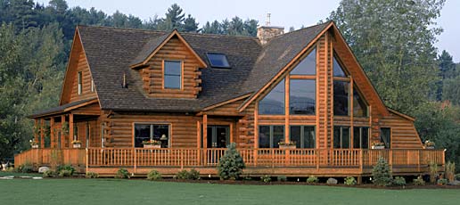

(i guess) as pictured not including property, turnkey would be $750000 to $1000000...

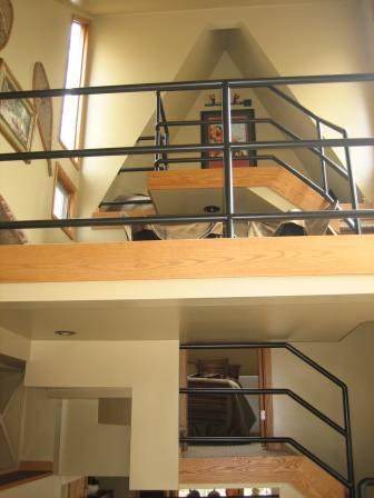

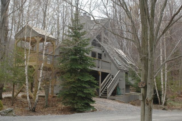

Not a log home but a timberframe. We just closed on this Friday May 11. I love this place and 30 yards to slopes. Its in Canaan Valley West Virginia at a ski resort called Timberline.
3 hrs door to door from our home in Northern VA.
Is he kissing it? Or suckling on the nipple?
