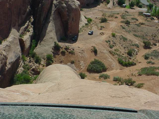

Old 07-03-2007, 06:14 PM
Default Re: Can Somebody Explain Gearing
i use 1st and 2nd in low range for going very slow . 1st going down steep stuff .
hi range is good for sand and snow when you dont need to crawl
1st gear no brakes no problem
Old 07-03-2007, 07:04 PM
stagger_lee's Avatar
Join Date: Jan 2007
Location: Southern Cali
Posts: 652
Same obsticle, no gears, or brakes for that matter!
http://www.youtube.com/watch?v=fpbkTncjEOs

Old 07-05-2007, 06:19 PM
Viet Nam Vette's Avatar
Location: Atlantic City NJ
Posts: 1,453
Freaken Lions Back...!!! That's Fargen Scary... I'd be puken on the dash go-en down that sucker. I'd have to burn some bush weed to chill out.
