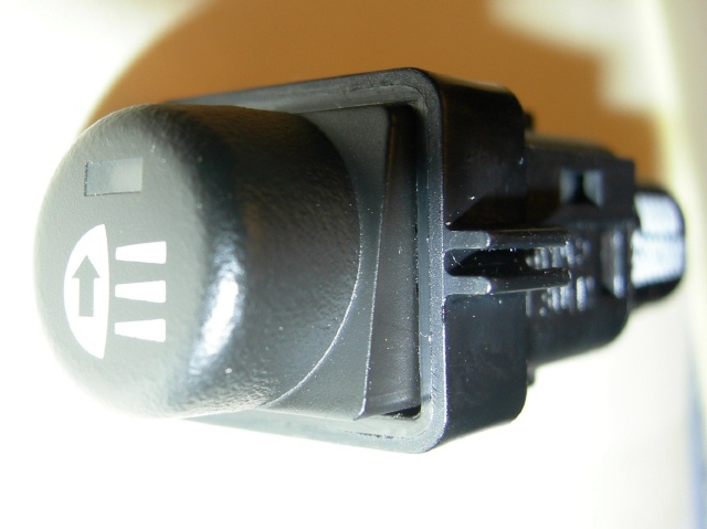

I am also interested in putting a pair of lights on my brush guard. I have the factory H3X brush guard that has all squared off pieces(not round). If I get these I would want them to be controlled by one of the "blank buttons" next to the power outlets. What lights would be good to put on this brush guard and is it possible to control them this way. Does GM sell just the buton that goes there, like the one that comes with there roof mounted lights. If so where can this be purchased?

yes as far as i know gm does sell just the button, may be wrong, someone will correct me if i am. if not you can use another button. but they can be hooked up the way you want.

I can help you with the buttons, i got them from http://hummer.autowebaccessories.com

Installing the Button Switch
Remove one of the button blanks from the bezel and snap thte butto switch into place. I used the left one because the other is my AUX input for the head unit.
